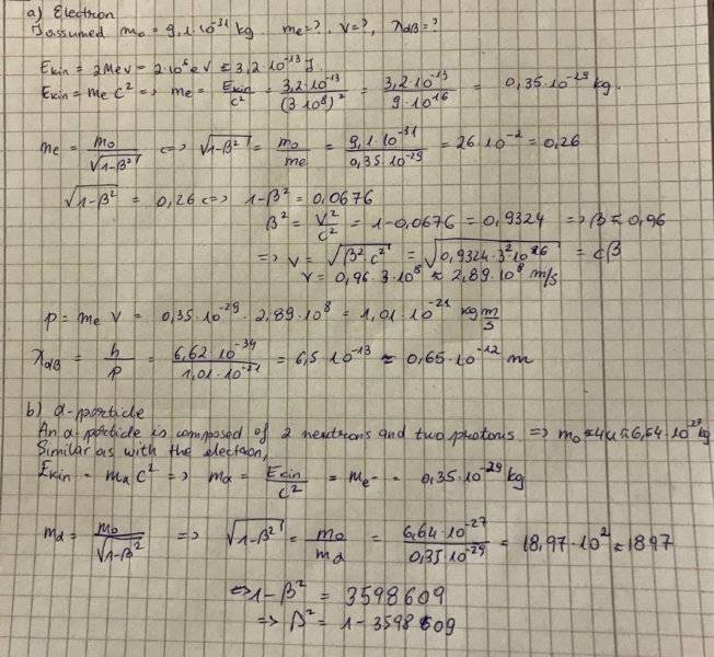

Calculate the mass, velocity and the de Broglie wavelength of an electron and an alpha particle, given the kinetic energy K = 2MeV
please find attached![/B]
I went through my calculations again and I think I have one problem in determining the formula of relativistic kinetic energy. What I used is: E = m*c^2, where m - the effective mass of the electron. I'm afraid I should've used
E = m*c^2 - m0*c^2, where m = m0/sqrt(1-β^2). Is that correct?

You're correct about the error. I prefer to use ##m## to refer to the invariant (rest) mass, but to avoid confusion I'll stick with your notation and terminology. So ##K = mc^2 - m_0c^2## or ##(m - m_0)c^2##.
Or you could just say the total energy is 2 MeV plus the rest energy of the electron, 0.511 MeV. So then ##mc^2 = 2.51## MeV. Go through all the same steps but using that value of total energy rather than the 2 MeV.

However, if I apply the relativistic energy formula also for the alpha particle, I get that effective mass is approximately the same as the rest mass. So I would get that β=0, which is not possible. What am I doing wrong?

An alpha particle is two protons and two neutrons, each of which has a rest energy of approximately 1 GeV. So 2 MeV is a very small fraction of the rest energy and this particle is not relativistic. Use the low-velocity formula ##K = (1/2)mv^2##.
To be precise, the rest energy of an alpha is 3.727 GeV, so 2 MeV kinetic energy increases that to 3.729 GeV total energy. If you want to use the relativistic formula, the increase is a factor of 3.729/3.727 = 1.00054 = ##1/\sqrt{1-\beta^2}##. ##\beta## is indeed close to zero, meaning as I said this is not a relativistic particle and it is moving at a small fraction of ##c##.
In contrast, the electron has a total energy of 2.5 MeV which is nearly 5 times its rest energy, so that is definitely a relativistic particle.
It's often a good idea to first do a sanity check to see "is this a relativistic particle or not?"
