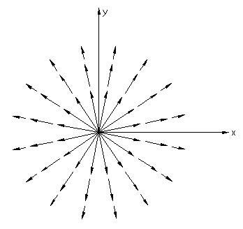

The question is to draw the function:
[tex]V=\frac {\boldsymbol{\hat {r}}}{r^2}[/tex]
And to compute it's divergence: [itex]\nabla \cdot V[/itex]
[tex]\nabla\cdot V=\left ( \frac {\partial}{\partial x} \boldsymbol{\hat {x}}+\frac {\partial}{\partial y} \boldsymbol{\hat {y}}+\frac {\partial}{\partial z} \boldsymbol{\hat {z}}\right )\left ( v_x \boldsymbol{\hat {x}}+v_y \boldsymbol{\hat {y}}+v_z \boldsymbol{\hat {z}}\right )=\frac {\partial v_x}{\partial x}+\frac {\partial v_y}{\partial y}+\frac {\partial v_z}{\partial z}[/tex]
[tex]V=\frac {x}{x^2+y^2+z^2}\boldsymbol{\hat {x}}+\frac {y}{x^2+y^2+z^2}\boldsymbol{\hat {y}}+\frac {x}{x^2+y^2+z^2}\boldsymbol{\hat {x}}[/tex]
The x component:
[tex]\frac {\partial}{\partial x}\left( \frac {x}{x^2+y^2+z^2}\right)=\frac {-2x^2+y^2+z^2}{(x^2+y^2+z^2)^2}[/tex]
And the other components are similar
I don't think this is the answer, since i was told to expect something special, maybe a number?
The vector field is, to my opinion, as in the picture attached

This derivative is incorrect. And even if it were it wouldn't be "the answer" because you haven't calculated the other two partial derivatives.
Why isn't the derivative correct?
The derivative of a fraction:
[tex]\frac {u}{v}=\frac {u'v-v'u}{v^2}[/tex]
And, in our case:
[tex]\left ( \frac {x}{x^2+y^2+z^2} \right )'=\frac {1 \cdot (x^2+y^2+z^2)-2x \cdot x}{(x^2+y^2+z^2)^2}=\frac {-x^2+y^2+z^2}{(x^2+y^2+z^2)^2}[/tex]
Yes, that is correct. And not what you had before.
Now calculate the other two partial derivatives and add them.
