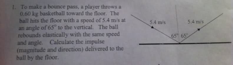

Below is a snapshot of the question I can't seem to solve.
I can't seem to find in my textbook how to work out this problem...:(
Any pointers? Thanks!

What is the mathematical definition of the impulse?
Impulse is the change in momentum
Show us the equation(s). That would be what you should have put in the "Relevant Equations" part of the Homework Help Template above...
Then tell us what you think you should do with the equation(s). That would go in the last part of the HH Template...
Is this correct??
ΔPx = m(Vfx - Vix) = .60(-v sin 65 - v sin 65)
= -2mvsin65
-2(.60)(5.4)(.90) = - 5.8
Ok now I am gettin stuck?
