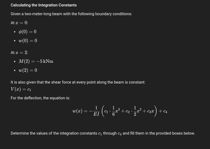

Is it even possible to solve C1 and C2?
I feel like I'm missing some information. (possible the teacher made a mistake)
Normally, a shear force or a diagram is given, but in this case, it is not known or given.
Could anyone guide me?

I'm not sure, but lets see if you can satisfy all the conditions. ## w(x)## is given as a deflection. It's usually a distributed load in the texts I've seen but...whatever.
Can you show your work?

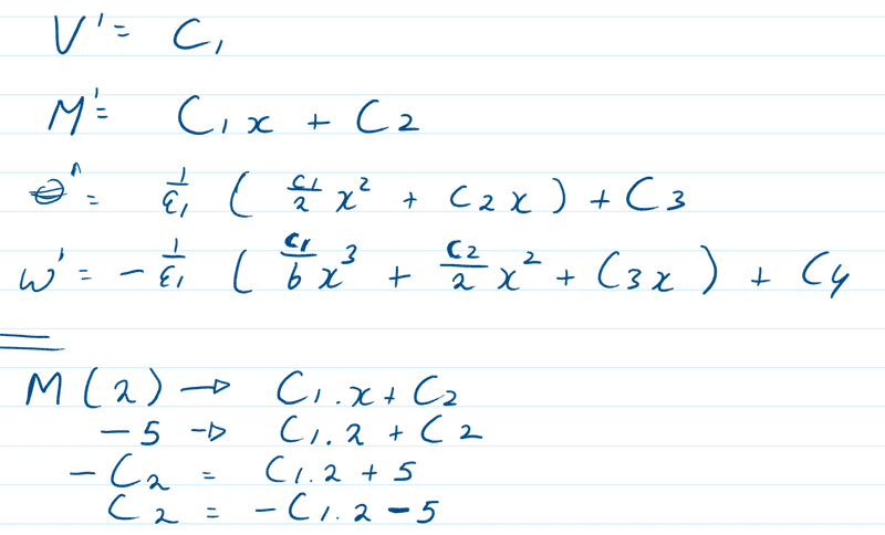

I'm not quite sure what you're referring with "if I can satisfy all the conditions". Anyway, the steps to get to the deflection equation is also a little bit confusing to me, because there is a '-' sign before 1/EI.
I've tried getting the C2 by substituting the M(2) = -5 in the M equation. Is this the right approach?
I don't see how this is connected to integration, unless somehow the integration has already been done to arrive at the equation for w(x).
From the first boundary condition, w(0) = 0, it's simple to find ##c_4##.
From the other boundary condition, w(2) = 0, you get ##\frac{-1}{EI}(4/3 \cdot c_1 + 2 \cdot c_2 + 2 \cdot c_3) = 0##
Your screen shot doesn't provide any information about ##\phi## or M or V, so perhaps they enter into the calculations for ##c_1, c_2,## and ##c_3##.
In your work, what is ##\epsilon_1##? The equation shown in the screen shows E and I, but not ##\epsilon##. Also, your work shows ##\theta##. Did you mean ##\phi##?

Yeah, that's the right idea. You have 4 conditions and 4 constants to determine.
But instead of working "up" from the shear ##V(x)##, work "down" from the equation for deflection given ##w(x)##. Derive everything from the equation given (which has a negative sign out front as well as the constant ##EI##).
we have ##w(x)##, derive the others from it.
## \phi(x) = EI \frac{dw}{dx} ##
## M(x) = EI \frac{d^2w}{dx^2} ##

The integration has been done, we are supposed to derive the other relations from ##w(x)##.

It's an "##EI##"
And the ##\phi## is ##EI\frac{dw}{dx}##.

Ah that explains it! Thank you! :biggrin:
