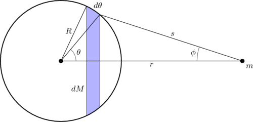

I'm trying to arrive at the gravitational potential at a distance r < radius of sphere(R). The integral is
\begin{equation}
V(r<R) = \int \frac{-GM}{2rR}ds,
\end{equation}
but I'm not sure how to select my integration limits.
Yes, a hollow sphere. I'm integrating small circles of the surface of the sphere. I guess this image describes it well.
Diagram of a circle of radius R with centre at the origin and a point mass m a distance r to the right; a thin vertical band dM on the disc surface is shaded, with angles theta and phi marked and labelled distance s from the band to the mass.
That's a point r outside the sphere. In that diagram, you first need to work out the gravitational potential of the ring marked in blue. So you're going to need to take θ into account and calculate dM as well.
Ok. So
\begin{equation}
dV(r<R) = \frac{-GdM}{S}
\end{equation}
\begin{equation}
dM = \frac{M}{4\pi R^2}d \theta R Sin \theta R 2 \pi
\end{equation}
\begin{equation}
dM = \frac{M}{2}Sin \theta d \theta
\end{equation}
\begin{equation}
S = \sqrt{R^2+r^2-2Rr Cos \theta}
\end{equation}
\begin{equation}
\frac{dS}{d \theta} = \frac{Rr Sin \theta}{S}
\end{equation}
Inserting in dV(r<R):
\begin{equation}
dV(r<R) = \frac{-GM Sin \theta S ds}{2SRr Sin \theta}
\end{equation}
\begin{equation}
dV(r<R) = \frac{-GM}{2Rr} ds
\end{equation}
\begin{equation}
V(r<R) = \int \frac{-GM}{2Rr} ds
\end{equation}
Is that right?
Not quite. If you think in terms of the force exerted by the ring, what is the direction of the force?
When the ring is to the right of P the force points left, and vice versa.
Yea, ok. I was thinking since each point on the circle has a point on the opposite side where the perpendicular component of the forces would cancel out the net force would be parallell to the axis through the center of the circle and P. Not so?
Yes, the perpendicular forces cancel. But what about the magnitude of the remaining force?
That would depend on the mass at P right? In any case it's
\begin{equation}
F = -\frac{GMm}{(r-R Cos \theta)}
\end{equation}
Take a look again at your diagram and make s a vector. That's the direction of the force. So, you have a "vertical" component and a "horizontal" component. The magnitude of the horizontal component is not the magnitude of the full force.
Then I don't know. You asked about the magnitude of the remaining force, isn't that the horizontal component of the total force?

I think you've got two mistakes cancelling out for the problem outside the sphere. But, they won't cancel inside the sphere.
You've got ##dV = -GdM/S## but that assumes that all the mass in the ring is concentrated at one point a distance S. You need to take cos(φ) into account. The potential must be:
##dV = (-GdM/S)cos(φ)##
If you imagine being very close to the ring, then there would be almost no potential. In fact, when φ = π/2, the potential will be zero.

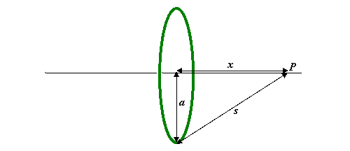

So I checked my book:
Diagram of a ring of radius a centred on a horizontal axis, with a point P on the axis at distance x from the ring's centre and a line s joining P to a point on the ring.
The potential dV(x) at P from dM, that is now a small part of the ring, at distance S is given by:
\begin{equation}
dV(x) = \frac{-GdM}{S}
\end{equation}
\begin{equation}
dM = \frac{M}{2 \pi R}Rd \theta
\end{equation}
So
\begin{equation}
V(x) = \frac{-GM}{2 \pi S}\int_0^{2 \pi}d \theta = \frac{-GM}{S}
\end{equation}
So when S = R the potential is not zero, it's just the lowest possible value for any point on the axis through the ring's center. However the gravitational field will be zero, since g(0) = -∇V(0) = 0.
I think you are right about the cancelling though. Gravitational potential doesn't cancel out. The potential is exactly the same for every dM on the ring so the potential from the ring is just the sum of potential from all the dMs. So for the hollow sphere the gravitational potential is just the sum of the potential from all the rings in the sphere. So since the inside of a sphere is a equipotential region(source: wikipedia) V = constant for any point inside the sphere. I believe this is correct.
