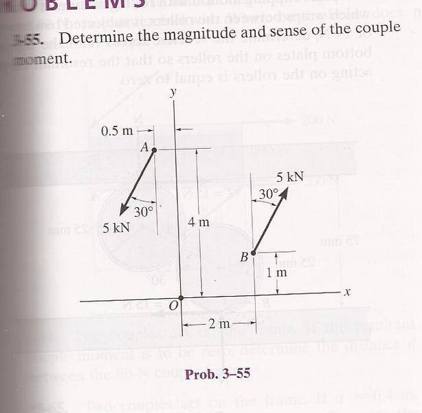

Calculating the magnitude and sense of a couple moment
The discussion focuses on calculating the magnitude and sense of a couple moment in a mechanics problem. The participant attempted to solve the problem by creating moments at two separate points but arrived at an incorrect answer. The correct value for the couple moment is established as Mc = +18.3 kN·m. The participant seeks clarification on potential mathematical errors or missed steps in their approach.

question is attached with thread
Is attached with thread. I tried solving by creating a moment at a point, which I did at 2 separate points points to give me the same answer, which I would expect, however it is not the answer I am looking for, the actual answer is Mc=+18.3kN.m. If I made a mathematical error, what have I done? If I missed a step, which step did I miss and if it is neither of these and I am supposed to take a different approach to the problem, how should I do this. Thanks in advanced for any assistance
