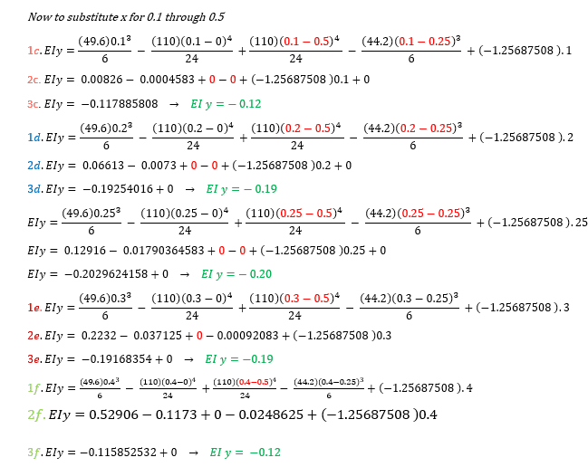

Determine the position and magnitude of the max bending moment
The discussion revolves around determining the position and magnitude of the maximum bending moment in a simply supported beam subjected to a point load (a cat) and a uniformly distributed load (snow). Participants explore various methods for calculating bending moments, including the use of Macaulay's method, and address issues related to unit conversions and arithmetic errors.
  • Homework-related
  • One participant describes a method for calculating the maximum bending moment using a point load and a uniformly distributed load, noting difficulties with their calculations.
  • Another participant suggests converting the uniformly distributed load to a single equivalent concentrated load for simplification.
  • A participant calculates the total snow load as 55 N and discusses its distribution across the beam, emphasizing the difference in maximum moments between concentrated and distributed loads.
  • Some participants express concerns about arithmetic errors and the importance of using the correct distributed load value in calculations.
  • There are mentions of the need to verify calculations using Macaulay's method, with participants indicating they are unsure about their results.
  • One participant questions the origin of a stated 10 kN load, pointing out inconsistencies in the calculations presented by others.
  • Another participant acknowledges previous errors and commits to reworking their calculations based on feedback received.
  • Some participants note the challenges of discussing calculations presented as images, suggesting that numbering equations would improve clarity.
  • There is a discussion about the significance of identifying the point of maximum moment and the relationship between shear and moment diagrams.
Participants express various viewpoints on the methods used for calculating bending moments, with some agreeing on the need for corrections while others highlight different approaches. The discussion remains unresolved regarding the best method to apply and the accuracy of the calculations presented.
Participants have noted potential errors in unit conversions and arithmetic calculations, as well as the need for clarity in presenting mathematical work. There is also an acknowledgment of the challenges posed by using images for complex equations.

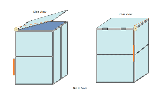

That sounds like an interesting method which I am unfamiliar with. I am interested to learn a bit more about calculus as I have not used it a great deal throughout my course. I am going to set myself a further challenge to complete which you may be able to assist me with using alternative methods. I am looking to design a automated system to open an close the lid of the greenhouse using a counterweight and a microservo to tip the balance given by the weight.

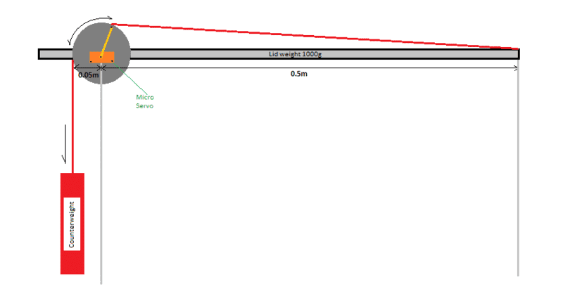

I have put together this diagram of how it would look and I have made a diagram for the lid and mechanism to show the calculations required. As this is a fictional project I am going to say the net weight of the lid is 1kg or 1000g to simplify the calculations. The micro servo attached to the pulley will transmit the torque in favour of the counterweight to open or to the lid to close. I have produced a basic diagram of how this would look.
I was going to follow my previous method showing the maximum bending moment required to tip the balance over to the counterweight. Again I can say the maximum angular torque available from the servo is 10g as I am not using genuine parts.
Is there anything you can offer me to get started with this problem? Thank you.

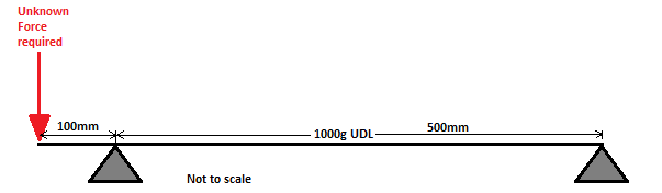

Here is a stripped down version with the facts I have set out to find the maximum force required at the big red arrow. I will do some calculations to try and get some results myself.

If you want a real workable design, this is not it. The problem is that the torque exerted by the counterweight is roughly constant, whereas the torque load from the lid will reduce as it rises.
To fix that, hang the counterweight from that stub of lid that sticks out to the left. Now it is just a seesaw.

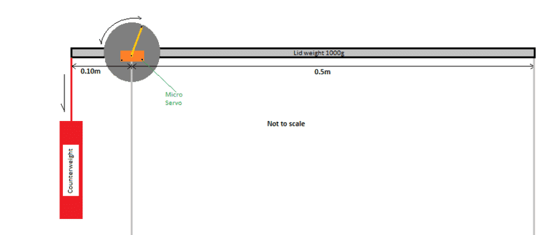

I have redrawn the diagram to show the idea. I have started with working out the net weight of the lid as a UDL and worked out 1000g into Newtons = 9.81N. as a UDL this would be 9.81/0.6m = 16.35N.

  • #36
For the purpose of calculating the counterweight's mass, no need to figure out the force in Newtons. Mass ratio is inverse of distance ratio.

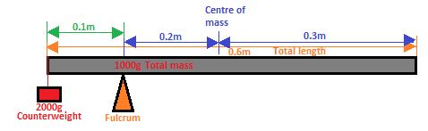

  • #37
So the overall weight of the lid would be 1000g but 100mm of it is beyond the left of the tipping point. So would I be correct by starting to divide the weight by 600mm.
1000g/600mm*500mm = 833.3g to the right of the pivot point.166.7g to the left and this ratio would be 1:5. so the weight required of the counterweight would need to be x4 of the left stub.
  • #38
It is simpler to leave the lid as a single weight but find its mass centre and use the displacement of that for the torque.
  • #39
So to find the mass centre would I be looking to 50% of 833.3g mass to the right of the pivot (416.65g).
I thought if the setup is effectively a seesaw then to balance each side equally then it would only take a small change in mass at one side to tip the balance and open the lid?
  • #40
The whole lid is 1kg and 0.6m wide. Its mass centre is 0.3m from each edge, so 0.2m from the pivot. Its torque about the pivot is (0.2m)(1kg)(g).
If the suspended mass is m, its torque the other way is (0.1m)(mg).
So to balance you will need m=2kg.

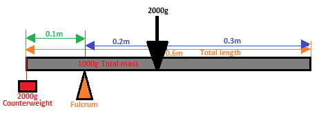

  • #41
So the torque about the pivot is equal to the counterweight mass effectively making the -2000g(clockwise torque being negative) + 2000g(the counterweight anticlockwise torque) = 0 Torque so no movement.
  • #42
Yes.
  • #43
I am trying to understand how the mass at twice the distance to the right of the pivot can be equal to the mass balancing it at half the distance to the left of the pivot?
From your information I worked out the torque about the pivot to be 0.2 x 1000g x 10 which gives 2000g at 0.2m and the counterweight mass to be 2000g at 0.1 to the left? I would have expected it to be double to compesate for the distance?
  • #44
No, it gives 200g gram-meters.
(To avoid confusion, let's write out gram in full and reserve 'g' gravitational acceleration. Alternatively, we can switch to kg.)
That's a torque, so it is not "at" anywhere. You have already used the 0.2m info.
It balances the 2000 gram x 0.1m x g = 200g gram-meter (or 2 Newton-meter) torque from the suspended mass.
I note that in your diagram in post #43 you have written that the mass of the lid is now 2000 grams. I assume you meant it has a torque of 2 Newton-meters.

Yes, I was trying to visually represent the Torque as it helps me to try and understand the logic of the situation. I think my fault in understanding your method is because I have not used the units gram-meters anywhere in my course so far and I am unfamiliar with it. I have just googled a gram-meter and know I understand its value to a Newton meter.

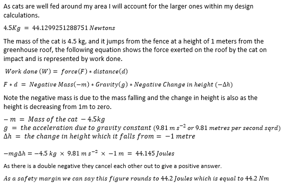

I was checking my initial calculations regarding the weight of the cat impacting the roof from 1 metre and I got 442Nm of force in my method. I have just recalculated and got 44.2Nm. Does this look correct in the method?
Please create a new thread for this. It is a forum standard that each distinct problem has its own thread. I should have insisted on that for the lid counterweight question.
If you want to make sure I see it, put @haruspex in the text.
