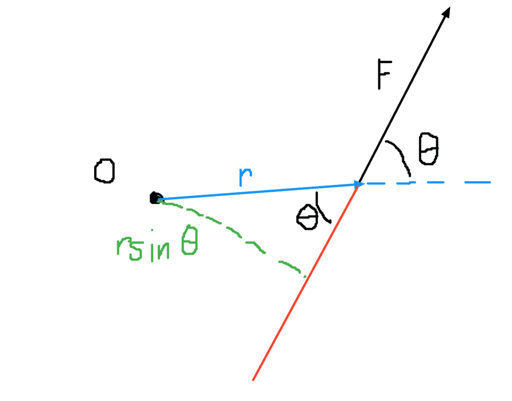

You can do it without components by remembering the fact that we can find the moment by multiplying the force by the perpendicular distance to the line of action of the force?
What does 'line of action mean'? That is the extension of the force vector in both directions to form a line - it shows the direction along which the force acts. I hope that makes sense
Why is this the case?
$$ \vec M = \vec r \times \vec F = |F||r|sin(\theta) \hat n $$
(EDIT: the ## \hat n ## denotes the direction of the moment vector as explained below by @etotheipi ) where we can interpret ## r sin(\theta) ## as the perpendicular distance (from the origin) to the extended line of action. Just in case this doesn't make sense I have included an illustration below. Apologies I am not used to writing with my mouse. The red line is an extension of the force vector and represents the 'line of action'. As we can see the force is ## F ## and the perpendicular distance to the line of action is ## r sin(\theta) ## and therefore the magnitude of the moment is ##Frsin(\theta) ##
Now back to the main problem, that means that we don't need to use components if we can find the perpendicular distance to the line of action of the force (we already know what F is) and then we can multiply the two. I would suggest that you extend the force vector line below point ## O ##.
Complete the semicircle that touches the line of action and see whether that helps
If this still doesn't make sense, then I will be happy to clarify where possible.

Master1022 said:
$$ M = \vec r \times \vec F = |F||r|sin(\theta) $$
I would just clarify that the moment is a vector orthogonal to ##\vec{r}## and ##\vec{F}##,$$\vec{M} = \vec{r} \times \vec{F} = |\vec{F}| |\vec{r}| \sin{(\theta)} \hat{n}$$The component along the ##\hat{n}## direction is$$M_n = (\vec{r} \times \vec{F})_n = |\vec{F}| |\vec{r}|\sin{(\theta)}$$ And its magnitude is$$|\vec{M}| = |\vec{r} \times \vec{F}| = |\vec{F}| |\vec{r}| |\sin{(\theta)}|$$
