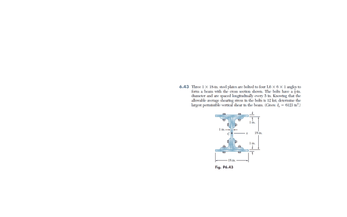

So I'm trying to check the moment of inertia Ix for this weird I beam. The three steel plates' moments of inertia were easy enough to calculate. However, I would appreciate any help on how I should go about calculating the contribution of the four L6x6x1 angles to the total moment of inertia. Thanks.
hi eurekameh! :smile:
(btw, physicists call that moment of inertia the "second moment of area" :wink:)
but isn't Ix given in the question? :confused:
