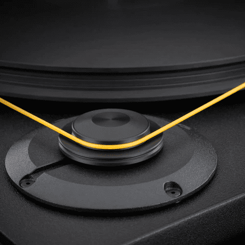

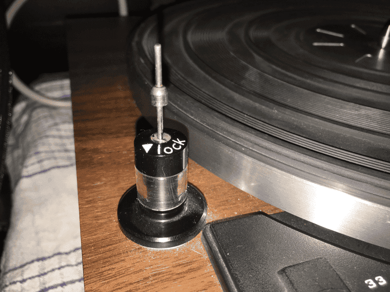

You may want to consider a capstan wheel turntable. For example, vinly record turntables use them as in the picture. The advantage is that the electric motor can run at much higher RPM than the turntable. Motors are more efficient at higher RPM. Also, startup from a complete stop is easier with a capstan.
The capstan wheel on the motor shaft, can either touch the turntable as in this picture.
Or the motor shaft can drive a belt that goes around the turntable as in this picture.
