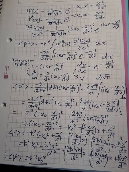

Here is my attempt at a solution.
I got ħ2k2. The correct answer is ħ2k2 + ħ2/(2d).

Working in momentum space by first Fourier transforming the given wavefunction might help minimize the possibility of error during calculation.
Thank you. Unfortunately I have no idea how to do that. Did you see an error in my calculation?
I didn't go through the detail but it is strange that you still have ##x## after finishing the integral, although the terms containing it eventually cancel in the final step. You were doing a definite integral over ##x##, so logically this variable should not appear after the integral is evaluated.
I was doing a definite integral? Where? I shouldn't be doing definite integrals.

You are, in calculating the expectation value you integrate from ##-\infty## to ##+\infty##.
Oh. I thought that because the limits were infinite that it would be an indefinite integral.
The second derivative of ##\psi(x)## is not correct.

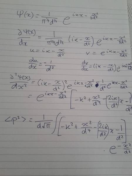

Thank you for that correction. e should be to the power of ikx-(x2/2d2.) But it still doesn't change the answer. The mark scheme said that for some reason (ik-(x/d2))2 simplifies to -1/d2. I don't know how this is possible!
You seem to be not getting the correct second derivative yet. Ok, could you please show how you got the first derivative ##\frac{d}{dx}\psi(x)##?

I tried the derivative again but it doesn't simplify to what you are saying for some reason:
The second derivative looks right. But, you're still taking an indefinite integral for some reason:

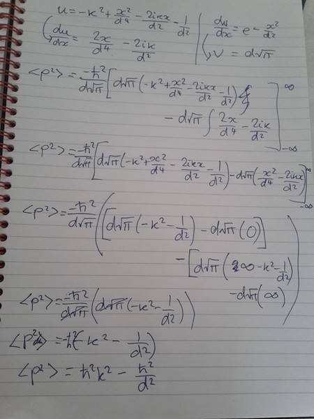

The final answer should be ħ2k2+(ħ2/(2d2)). But I get the following:
You made a mistake when calculating ##v##. If you want to do this problem via integration by part, then you should have left ##v## as a function, not a number. In other words you shouldn't evaluate it yet with the given limits. I strongly suggest that you compute ##\langle p^2 \rangle## directly term by term using the relations you already have under the relevant equations part.

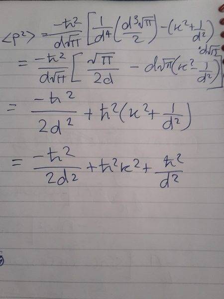

Almost there. I got this answer:
How would you simplify ##\frac{\hbar^2}{d^2} - \frac{\hbar^2}{2d^2} = \frac{\hbar^2}{d^2}\left(1-\frac{1}{2}\right)##?
