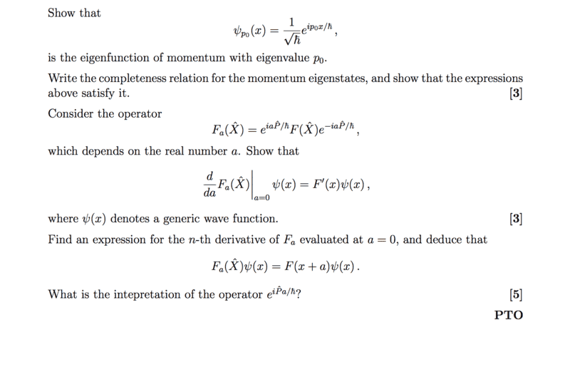

Typeset problem text: Show that psi_p0(x) = (1/sqrt(hbar)) e^(i p0 x / hbar) is the eigenfunction of momentum with eigenvalue p0. Second part asks for the completeness relation for momentum eigenstates [3 marks].
##\hat{P}= -ih d/dx##
To actually obtain ##\psi_{p_0}## I guess one can apply the momentum operator on the spatial wavefunction. If we consider a free particle (V=0) we can easily get obtain ##\psi = e^{\pm i kx}##, where ##k= \sqrt{2mE/ \hbar}##.
By now applying momentum operator we get ##\hat{P} \psi= -ih \cdot \pm i \sqrt{2mE/ \hbar} ##. This is as far as I get, how do I actually get the eigenfunction of momentum on the required form?
And 2:
How do I show that the completeness relation is satisfied for that 'specific' expression? I know that we can express ##|x> = \int dp |p><p|x>,##take ##-i \hbar \frac{d}{d_x} f_p(x) = p f_p(x)## and turn into a Fourier transformation (including k in the kernel) and get ##p' \tilde{f_p(p')}## which can be solved picking p=p' and any function of p can be converted into an eigenfunction if we transform back to x s.t ##f_p(x) = \int dp e^{ipx \hbar} \tilde{f_p(p)}##, but I have no idea how to use this to confirm the completeness relation for the above expression...

1) You do not need to derive the eigenfunction. Just show that the given function is the eigenfunction.
2) You need to show that ##\int |p\rangle \langle p| dp## is the identity operator, i.e., that acting on any state with it gives back the same state.

The wave function ##\psi(x)## for any state ##|\psi\rangle## is defined as ##\psi(x) = \langle x|\psi\rangle##.
Oki I see. Are there way to get p for this specific case which I ultimately can plug into the completeness theorem?
There is no specific p. The ##p## in the completeness relation is an integration variable.

You should not be checking it for a specific case. You should show that it is always the identity operator.

Yes? You are still not understanding the question correctly. The wavefunction you are given is the wavefunction corresponding to the state ##|p_0\rangle##. You need to show that the states with this type of wavefunction lead to the states satisfying the completeness relation.
Cheers. Yes the reason I ask is that I obviously don't understand it.
That the wavefunction of the momentum states is ##\psi_{p_0}(x) = \frac{1}{\sqrt{\hbar}} e^{ip_0x/\hbar}## by definition means that
\langle x|p_0\rangle = \frac{1}{\sqrt{\hbar}} e^{ip_0x/\hbar}.
From this and the completeness relation for ##|x\rangle##, i.e.,
\int |x\rangle \langle x| dx = 1,
you should be able to show the states ##|p\rangle## with the above wavefunction satisfy the completeness relation. You can do this by showing that
\langle x|\psi\rangle = \int \langle x|p \rangle \langle p |\psi \rangle dp
for any state ##|\psi\rangle##.
