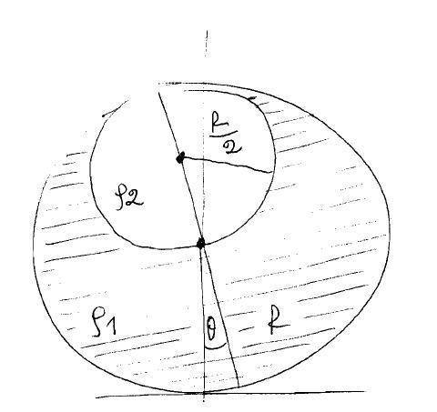

As you can see, I have a ball inside a ball.
One with a density p1 and the other p2.
the ball stand on a surface with friction so it can move without sliding.
they move the ball from its rest point and release it.
I need to figure out the period time, any idea?

Hi asi123! :smile:
(is there zero friction between the balls?)
The only way to approach this is to work out the equations of its motion first.
Hint: lots of things are being conserved. :wink:
