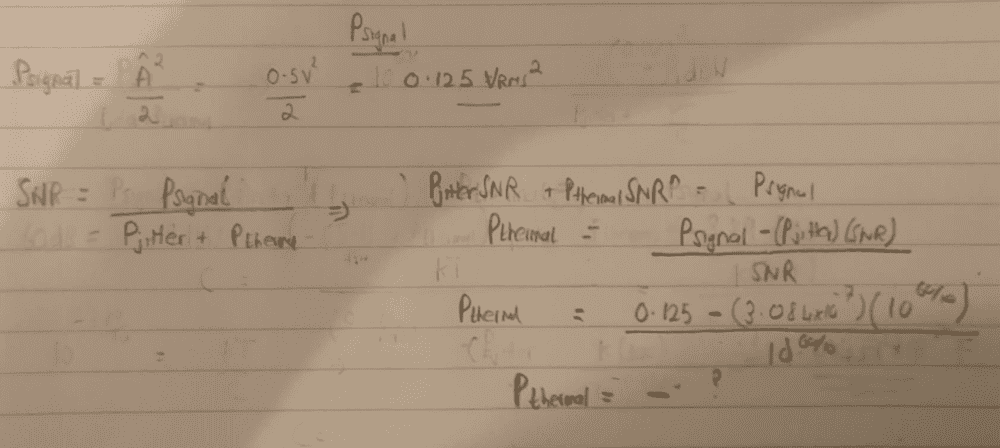

In sampling system the sample rate is 500 Ms/s with an input signal of range of 1 V
peak−peak and a clock jitter of 1 ps rms . A performance of 60 dB is required for all
signals the Nyquist baseband. Calculate its size of the capacitor.
Analog-to-Digital Conversion by Marcel Pelgrom Book

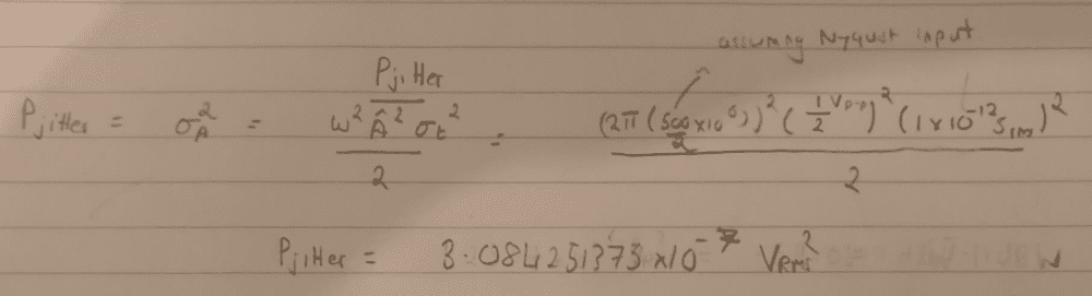

First, I calculate the jitter power with an equation given in the book

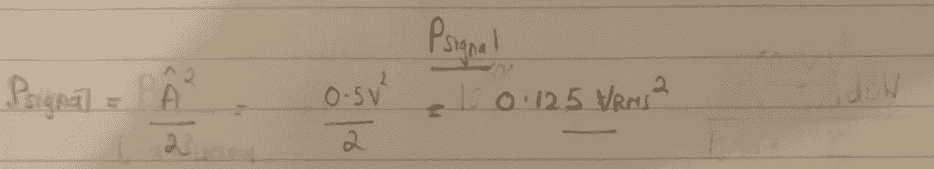

Next, I calculate the signal power

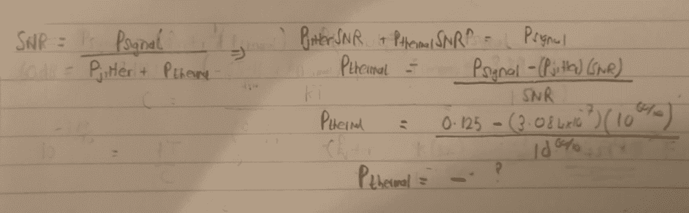

Now, I know that SNR = Psignal/(Pjitter + PthermalNoise),
However, I seem to be getting a negative value for the thermal noise power?? My plan was to use this thermal noise power and equate it to kT/C to get my capacitor size. But the thermal power is negative??
What am I doing wrong?

the thermal power is negative?? What do you calculate for the SNR?
your SNR is stated as 60dB, so the factor 10^(60/20) yields 1000 fold power ratio, so your scaled Pjitter is around 0.0003
0.125 - 0.0003 is positive not negative simple math mistake?
