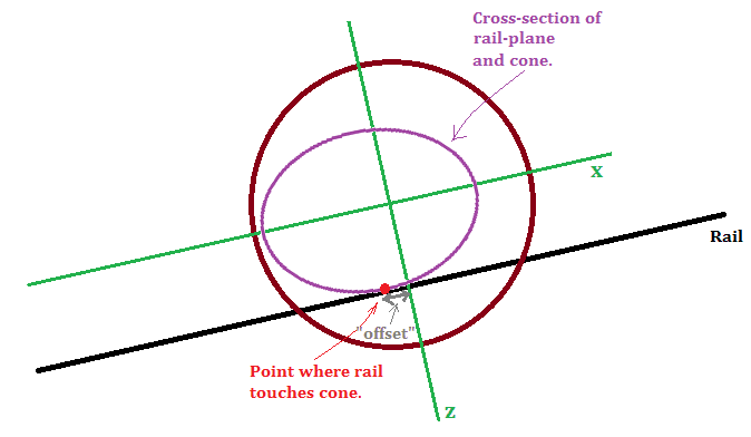

e) The assumption that the connecting line through the center of mass and the two pikes is always orthogonal to the rails is wrong. Analyse, where the rails really touch the double cone in the case of motion and find out what really happen in the point A.

Imagine a vertical plane that contains one of the rails. The plane will slice through the cone. The rail will contact the cone at the lowest point of the cross section. See the attached figure where you are looking at the cone along the axis connecting the apexes. For convenience, I drew the picture for the case where the plane of the rails is horizontal. The blue curve represents the cross section. The red dot shows the point of contact of the cone with the rail. You can see that the point of contact is offset from the apex by some distance ##d_0##.

Okay that means if d>0, the lines do not cross each other orthogonally. And d is zero if the double cone rolled a round, considered from the point A, right?
Yes, if you mean that line ##P_1P_2## is not orthogonal to the rail ##AB##. If this is not what you mean, can you specify the lines that you are talking about?
I'm not sure I understand this question. If you work out the "offset distance" ##d_0## as a function of ##d##, then I believe you will find that there must be some offset distance even at the starting point if you want the double-cone to rest on the rails at the starting point. So, the CM of the system would not actually be on a line through A and perpendicular to the plane of the rails at the starting point. Maybe this is what you are saying.
