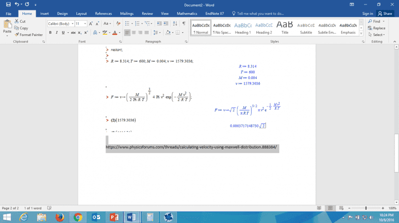

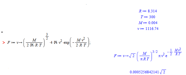

alright so this is what I have so far
Original equation and doing some rearranging, I get:
Maxwell speed distribution written as F := v -> (M/(2 Pi R T))^(3/2) * 4 Pi v^2 exp(-M v^2/(2 R T)), with a semicolon at the end.
Maxwell speed distribution written as F / (4 pi) := (M / (2 Pi R T))^(3/2) times v^2 times exp(-M v^2 / (2 R T)), typeset as a mathematical equation.
Equation: F / (4 pi) times (2 pi R T / M) raised to the power 3/2, assigned to v squared times exp of negative M v squared over 2 R T, ending in a semicolon.
Handwritten-style equation: ln[F/(4·pi) · (2·pi·R·T/M)^(3/2)] := ln[v² · exp(−M·v²/(2·R·T))], with a stray bracket at the right end.
Handwritten-style equation rearranging the Maxwell distribution: ln[F/(4 pi) (2 pi R T / M)^(3/2)] = ln v^2 + (-M v^2 / (2 R T)) in a math editor.
Equation: (-2·R·T/M)·ln[F/(4·pi) · (2·pi·R·T/M)^(3/2)] := ln v^2 + v^2
got this far?? Is this correct so far? I can't seem to isolate V
  • Screenshot of a Maxwell speed distribution worked in Maple-style math input in Word, with R = 8.314, T = 600, M = 0.004, v = 1579.3036 and F = v (M/(2 pi R T))^(3/2) 4 pi v^2 exp(-M v^2/(2 R T)) followed by a rearranged form with a numeric result of 0.0003717148730 sqrt(2).
  • Maths software screenshot showing the Maxwell speed distribution defined as F := v -> (M/(2 Pi R T))^(3/2) * 4 Pi v^2 exp(-M v^2/(2 R T)), with R = 8.314, T = 300, M = 0.004 and v = 1116.74 set above, and an equivalent simplified form beside it giving the value 0.0005256842141 sqrt(2).

The constant in front of the expression will divide out (cancel) on both sides. Try using the expression ## F(v)=(1/2)F(v_{mp}) ## and solving for ## v ##. You can at least get a numerical answer. You should get two roots ## v_1 ## and ## v_2 ## for the temperature they gave you. I don't know that you will be able to get a simple algebraic expression for ## v ##. A suggestion would be to sketch the graph of ## F(v) ## and estimate what ## v_1 ## and ## v_2 ## are. If you tabulate the function ## F(v) ## using a spreadsheet and about 1000 points, that may be your simplest way of solving this.
yea I did use that equation and when I rearrange it would leave me with this:
Equation with R, T, M and pi: (-2·R·T/M) ln[ (1/2) f(vmp) / (4·pi) · (2·pi·R·T/M)^(3/2) ] := ln v² + v²
so now I just got to solve for V tho? I am on the right track? correct?
