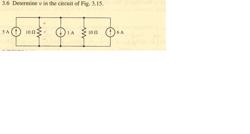

Using KCL at the top node of the branch whose voltage I'm supposed to find, I get this equation
5 - 1- i2 + 6 = 0
i2 is the current in third branch from left, whose direction has been chosen arbitrarily by me. Solving this gives me i2 = 10. And hence voltage through the third branch from left is 10*10. i.e 100. Since the branch in which voltage is asked is parallel to the branch of whose voltage I just found, they both have the same voltage, and thus, the answer to the question is 100. But that's not the answer they gave. Where am I going wrong?

The two 10 ohm resistors are in parallel. Replace with an equivalent resistor.
Okay, how do I do it without an equivalent resistor? I know what you mean. But I'm reading a new book, and they haven't reached equivalent resistors yet. They expect us to do it without the knowledge of it.
Also, equivalent resistor won't help here since I have to find voltage through a particular branch

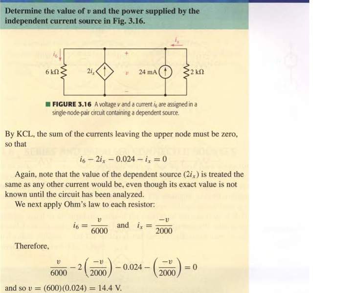

Also, can someone explain the passive sign convention? My problems are always going wrong because of signs.
Please take a look at the attachment with his post too. How did he apply can I use my own direction for current? Because on doing so, my answer doesn't match.
What I did was took i6 in the opposite direction of what the author has taken. Hence all the current would be flowing into the node. That would give
i6 + 2ix + 0.024 + ix = 0
Also, why is one of his voltages negative? If current is passing through the 2k ohm resistor the way he has shown, according to the sign convention, shouldn't the voltage be positive?

In Node analysis always take the current arriving at Node as positive. For unkown currents take them arriving. For known currents take them positive if arriving and negative if leaving. It should be like
i1+i2+...+in = 0
The two resistora are in parallel. I studied series-parallel combinations in high school only.
They are asking to find the Voltage between two points. You can there are two resistors between those two points. You can replace them by one!
In the 2k ohm resistor the Voltake taken negative is correct. Remember ohms Law, it says V= IR, where I is by convention taken as current flowing from positive to negative terminal. Here in th 2k ohm resistor the current is flowing from 'negative to positive'.
And you KCL equation is right. Use your equation.
Okay, thanks! Got it.
