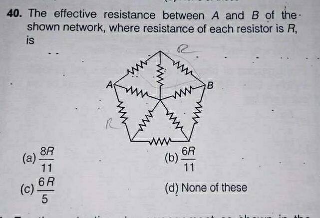

I will call the topmost node T , middle node M , bottommost left node L and bottommost right node Q .
I tried to use symmetry arguments . If I connect a battery across AB , i1 flows through branch AT , i2 through AM , i3 through AL . From symmetry , i1 flows through branch TB , i2 through MB , i3 through QB .
The resistors between T And M , L and M , Q and M can be removed .
Now we have three parallel branches 2R||2R||3R between A and B . Their effective resistance is 3R/4 .
But this is not an option . Could someone help me with the problem .

Can you really delete the resistors LM and QM? What is the voltage halfway between L and Q? At M? At T? Could you connect those points together without affecting the current flow?
I understand my reasoning is wrong . Could you please explain why the symmetry argument in the OP is wrong . I am not good with these types of problems .

If the voltage at L is not the same as the voltage at M, then current must flow between those two points, so the resistance on that branch will contribute to the total resistance.

Replace the resistor between L and Q with two resistors in series, each with resistance R/2. What is the voltage at the point between the two resistors?

You said you wanted to connect a battery across A and B. Let the voltage at A be 0 and the voltage at B be ##V_B##. What is the voltage at T, M and halfway between L and Q?

I converted the delta formed by nodes LMQ into star, and I am getting one of the options.

Yes it can. Look at the symmetry of the circuit.

The circuit is symmetric - the left side is the mirror image of the right side. So if the voltage at A is 0 and the voltage at B is ##V_B## and you draw a line down the middle of the circuit, what does the voltage have to be along that line?

Look at it another way. If you knew the resistance of the left side of the circuit was x, what would the resistance of the right side of the circuit be?

Hint: Look for balanced wheatstone bridge.

Is it 8R/11 i.e option a) ?
Yes.

You can consider them simultaneously. The two bridge-resistors R and R/3 will be redundant.

Since you have solved the problem (and I assume that you used the delta star transformation to do that), I will stop hinting around and explain what I meant. Substitute two R/2 resistors in series for the resistor between L and Q. Call the point between those two resistors K. If we draw a line through T, M and K, the part of the circuit on the right is the mirror image of the part on the left. That means that the voltage drop from B to T, M or K must be the same as the voltage drop from T, M or K to A. So if the voltage at A is 0 and voltage at B is ##V_B##, then the voltage at T, M and K must be ##V_B/2##. Since T, M and K are all at the same voltage, you can combine them into one point without changing the current flow through any of the resistors. When you do that you have a circuit that you can solve using just the series and parallel rules. Also, now the resistor between T and M has both ends connected to the same point (because T and M are the same point), so no current flows through it and it does not contribute anything to the effective resistance between A and B.
