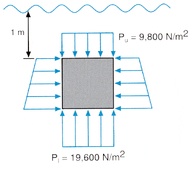

The magnitude of the force exerted over the area A by a hydrostatic pressure P is numerically equal to the volume of a prism which has a cross sectional area equal to A and a length equal to P units.
Consider a block which measures 1 m x 1 m x 1 m which is submerged in fresh water which has a density of 1000 kg / m3.
If the top surface of the block is located 1 m below the surface of the water, the pressure PTOP will be PTOP = ρ g h = 1000 ⋅ 9.8 ⋅ 1 = 9,800 N/m2.
PTOP is constant over the entire area of the top of the block, which is ATOP = 1 m2. The volume of the pressure prism for the top of the block is Vpressure prism = PTOP × ATOP = 9,800 N/m2 x 1 m2 = 9,800 N. It just so happens that the force of the hydrostatic pressure acting on the top of the block is also 9,800 N.
A similar calculation can be made for the bottom surface of the block, but in this case h = 2 m and PBOT = 19,600 N/m2.
The sides of the block form a more complicated pressure prism, which has a trapezoidal cross section.
At the top of the prism, the hydrostatic pressure is 9,800 N/m2, while the pressure on the bottom is 19,600 N/m2, and the pressure at any depth in between the top and bottom of the block varies linearly. The average pressure on the sides, PAVG = 14,700 N / m2, can be used to calculate the force due to hydrostatic pressure acting on these surfaces.
