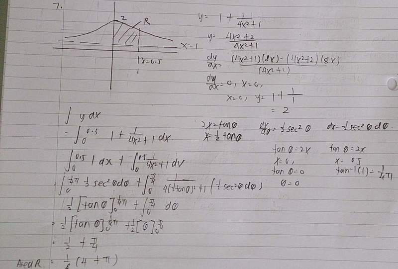

i have done the part a, for b , i use the key in the (circled part equation ) into calculator .. my ans is also different form the ans given. is my concept correct by the way?

One obvious point is that you are missing a factor of "[itex]\pi[/itex]". The area of a circle is [itex]\pi r^2= \pi y^2[/itex].
after adding pi, my ans is 2.80... the ans is 5.047746784, which part is wrong?
It would be a good idea here to use vertical line segments, otherwise you're going to have to set up multiple integrals. So leave everything as ##y(x)##, then:
##r_{in} = 0##
##r_{out} = 1 + \frac{1}{4x^2 + 1}##
##height = dx##
##dV = 2\pi(\frac{r_{in} + r_{out}}{2})(r_{out} - r_{in})(height)##
Integrating the volume element should give you the answer you want.
delsoo, your method is fine and I seem to get the same definite integral as you (which gives the correct answer too). The definite integral you have to evaluate is:
$$\pi\int_0^{1/2} \left(1+\frac{1}{4x^2+1}\right)^2\,dx$$
If you drop the factor of ##\pi##, you should get 1.60675.
Use the substitution ##2x=\tan\theta## to make things easier.

Ah, I think I worded it poorly. What I meant was this:
$$\int_0^1 \left(1+\frac{1}{4x^2+1}\right)^2\,dx=1.60675$$
And I feel delsoo did some mistake while evaluating the above definite integral.
