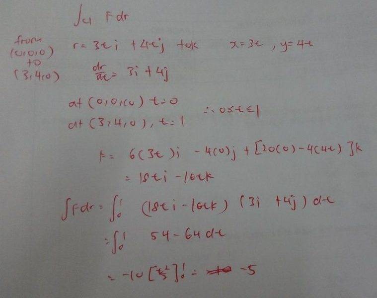

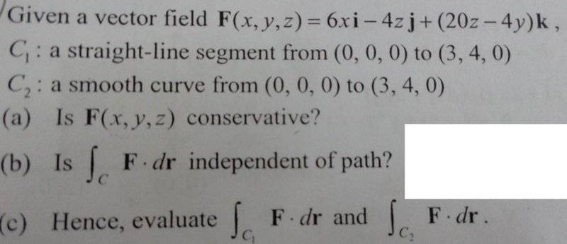

I am having question with part c , for both c1 and c2 , here's my working for c1 , i didnt get the ans though . My ans is -5 , but the given ans for c1 and c2 is 27 , is the ans wrong ? Or which part i did wrongly ?

## z=0 ## in the ## \hat{j} ## term, and the ## \hat{k} ## term in ## d \vec{r}/dt ## equals zero, so that both the ## \hat{j} ## and ## \hat{k} ## terms are equal to zero. You left off the ## t ## term in the ## \hat{i} ## integral term. With these corrections, I think you will get the correct answer.
