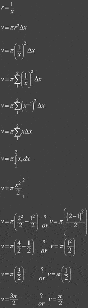

Find the volume of the solid obtained by rotating the region bounded by the given curves about the specified line.
y=1/x, x=1, x=2, y=0; about the x-axis
About halfway down, I diverge into two methods. The one on the left I use the method from FrogPad's post in my other thread (or at least my effort to understand the method he describes, btw, thank you). But it gives me 3pi/2. The one on the right gives me the same answer as the back of the book, pi/2. Maybe neither is right, and I coincidentlly got the right answer using the method on the right :bugeye:
Also, am I using the right symbols, etc.?
Handwritten-style derivation of a volume of revolution: r = 1/x, then disc-method sums of pi r squared times delta x, leading to integrals from 1 to 2 and two competing results, pi/2 and 3pi/2.
Why do you start off with a summation? Also: the limits are unclear (what is the variable?).

...and
[tex](x^{-1})^2\ne x[/tex]
but
[tex](x^{-1})^2= x^{-2}[/tex]
with the limits, your left-hand column would be right (assuming the integrand is right, as above or in prev. post)
You started off fine. I don't know why you "diverged" as you put it.
(It would also, by the way,be better to write more than just math symbols in your work: explain what you are doing and what each formula represents.)
Using the "disk" method you can imagine the volume divided into many thin disk with center on the x-axis, thickness [itex]\Delta x[/itex], and radius equal to the y value= [itex]\frac{1}{x}[/itex]. The area of each disk is [itex]\pi r^2= \pi \frac{1}{x^2}[/itex] and so the volume is [itex]\pi \frac{1}{x^2} \Delta x[/itex]. The approximate volume of the whole figure then is the Riemann Sum [itex]\Sigma \pi \frac{1}{x^2}\Delta x[/itex].
Now, for some reason, you have [itex]\Sigma \pi x \Delta x[/itex].
Surely you know that 1/x2 is not x!
(Are you subtracting exponents- that's for multiplication, not repeated powers. xmxn= xm+n but (xn)m= xmn. (x-1)2= x-2.
Now take the limit as the number of disks goes to infinity: the Riemann Sum [itex]\Sigma \pi \frac{1}{x^2}\Delta x[/itex] becomes the integral
[tex]\pi \int_1^2 \frac{1}{x^2}dx= \pi \int_0^1 x^{-2} dx[/itex]<br /> That should be easy to integrate.[/tex]
Others have pointed out the errors in your OP. If you are about to integrate:
[tex]\pi \mathop {\int} \limits_{1} ^ 2 x \ dx[/tex], the way in the left is correct.
You should note that:
[tex]\mathop {\int} \limits_{a} ^ b x \ dx = F(b) - F(a)[/tex], where F is the antiderivative of f.
And in this case, you'll have: [tex]F(x) = \frac{1}{2} x ^ 2 + C[/tex].

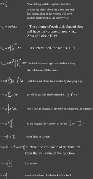

I re-did it and got the correct answer. I'll post my solution anyway, just in case I did something wrong and coincidentally got the right answer.
Thanks for all your explanations. This is starting to become clear. :smile:
Handwritten derivation of the volume of the solid formed by rotating y = 1/x about the x-axis, from x = 1 to x = 2, ending with v = π/2 and annotated with margin notes.
Nice LaTex style :smile:
For the limits, you can just put the numbers.
