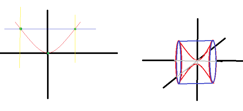

Are you trying to figure out what's going on with examples in your notes? If so, why don't you look away from them and just try this one from scratch. It kind of looks like you are trying to find the volume of y=x^2 rotated around the x-axis. That would be the 'negative half' that you subtract from the volume of the cylinder you get from rotating y=1 around the x-axis. Is that it?
I'm not using any notes. The examples I'm getting are randomly generated online. I'm trying to get the volume of the solid in between y=1 and y=x^2 rotated around the x-axis. I'm guessing it should look something like this?:confused:
Two graphs with x and y axes: left, a red parabola opening upward through the origin with a horizontal blue line at y = 1 and yellow vertical markers at x = ±1; right, a 3D rendering of a solid of revolution about the x-axis formed by red and blue surfaces.
As for creating an actual expression I'm not sure how to approach this problem.
I guess the interval would be from -1 to 1 since y=1 and 1=x^2 x=+-1 and x=0 at x=0 y=0
I'll try again I suppose.
∫ pi(1^2)-pi(x^2)^2 dx
that ends up giving me 8pi/5. The actual answer is 4pi/5 which i can get if the interval is from 0 to 1. My guess is that the problem was improperly worded and forgot to mention x=0 as one of the bounds. Either way thanks for your help. I really appreciate it!
