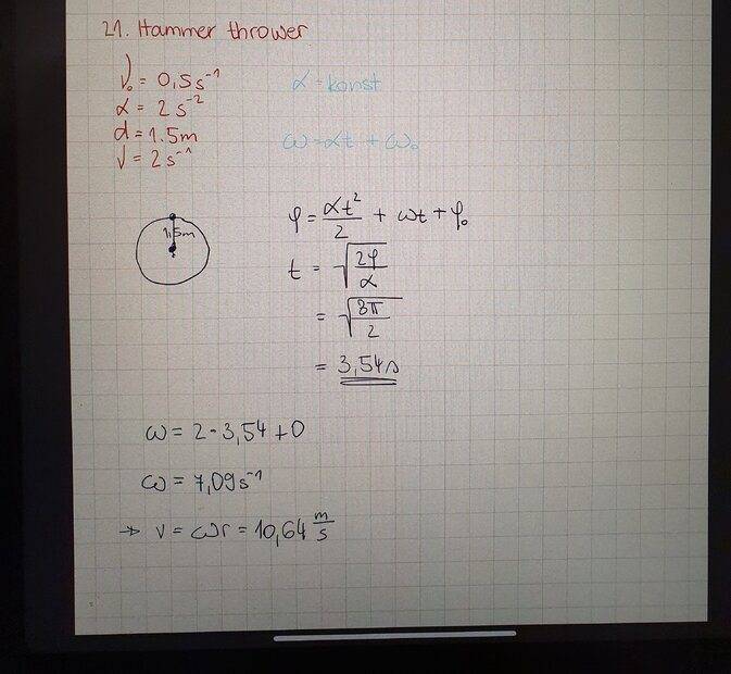

Hammer thower spins at circular frequency of 0.5 s-1 at one point and with constant radial acceleration in the same direction α = 2 rad/s-2. What angular velocity ω will he have after anoter 1.5 twist? What tangential velocity will the hammer have when the distance from rotation axis is d = 1.5 m?
ω = 2π/t0= 2πv
α = const.
ω = αt + v0
d = r ?
I'm already confused by the terms circular, angular and radial. I've read the definitions but I'm still confused. What is the difference? Is ω the right symbol for frequency that I used?
Any tips much appreciated!

OK, so after a little thinking I came up with this. Thank you everyone for your input!
The equation for the time to do the 1.5 twist assumes that the hammer starts from rest. We are told that, at the start of the 1.5 twist, the hammer "spins at circular frequency of 0.5 s-1" and has constant angular acceleration α = 2 rad/s2. We are not told how it started and how it got to that point.
If you want to find the time, you have to solve the quadratic equation that you wrote down ##\varphi=\omega_0~t+\frac{1}{2}\alpha~t^2##. Alternatively, you can bypass the time calculation and use the equation that relates the angular acceleration, angular displacement and the squares of the angular speeds.
knapklara said:
OK, so after a little thinking I came up with this. Thank you everyone for your input! ,
Please do not post working as an image. It makes it hard for us to pick out and comment on specific steps, and sometimes handwriting is unclear. Take the trouble to type it in. Use LaTeX, or the superscript/subscript controls (##X^1, X_1##) above the text panel. Or failing that, just type ^ in front of an exponent and _ in front of a subscript: v_0=0.5s^(-1).
I think your first equation is ##v_0=1.5s^{-1}##, or it could be ##\nu_0=1.5s^{-1}##. For clarity, it would be better to use ##\omega_0## for the initial angular frequency.
I don't understand your fourth equation, ##v=2s^{-1}##. What is this v and what given value is 2 per second?
Your fifth equation is ok, but it would be better with ##\omega_0## instead of just ##\omega##. It is the initial angular frequency.
As @kuruman points out, you failed to include ##\omega_0## in your sixth equation.
