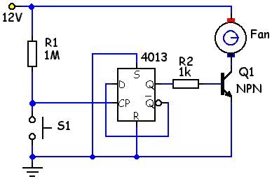

OK there are ways to use this style of switch to be able to switch a circuit on and off
here's one example ...
Circuit schematic of a 12V toggle-style switch circuit: a 4013 D flip-flop with R1 1M pull-up, momentary push-button S1, R2 1k resistor driving an NPN transistor Q1 that switches a DC fan.
this process is common in so much gear these days ... TV's VCR's DVD players etc etc
you will understand that that portion of the circuit will always have power on it
cheers
Dave
  • Circuit schematic of a 4013 D flip-flop toggling a fan: 12V supply, R1 1M pull-up resistor, momentary push-button S1 clocking CP, Q output driving R2 1k into an NPN transistor Q1 that switches the Fan.
