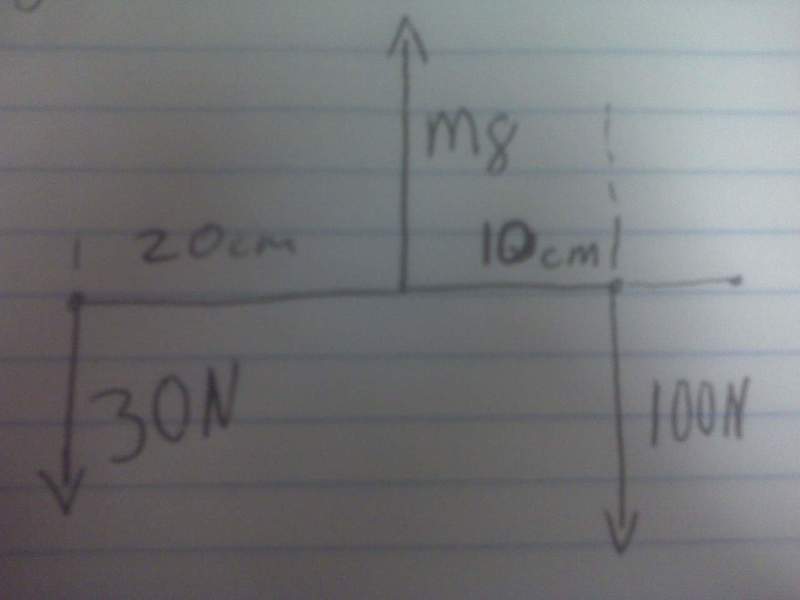

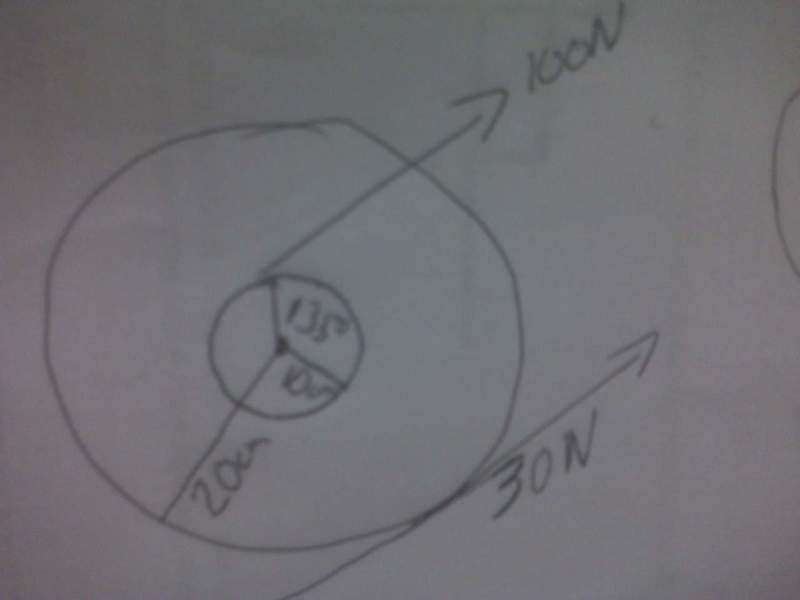

A car is on a hill. A force of 100n is applied to the axel by the motor in order to move the wheel.The frictional force btwn the wheel and the street is 30N. will the car move up the hill?
also the radius of the axel is 10cm and the radius of the wheel is 20cm. the angle in the picture is 135 degrees
i drew a force diagram. see pic . i came up with 10MN being applied and 6MN for the torque of friction. so yes it does

Yes you are right. The car is able to climb!
Assuming the forces on the incline are balanced (ie net forces are zero. Since the mass is not given, we can't verify that. But since it is not given, it means that the forces are balanced and the car is not moving backward with the wheels spinning forward)
So equilibrium of the forces are assumed.
So it is a matter of how much torque is generated by the axle.
axle torque = 100 * 0.1 = 10Nm
Frictional torque = 30 * 0.2 = 6 NM
So obviously we have 10 - 6 = 4 Nm of torque that is available for acceleration!
