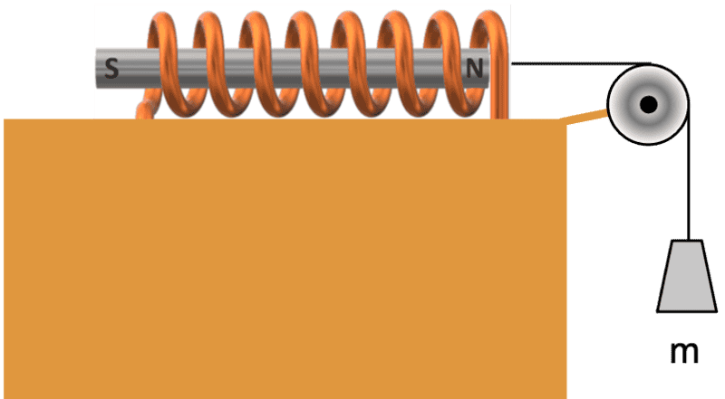

What I'm actually trying to answer is for example , if I had a coil beside a permanent magnet, the coil was connected to a cord the coil moves laterally horizontal to gravity, the cord then goes round a single pully wheel with a 2.5kg weight attached to it. It is allowed to fall 5mm , would this be enough to produce 12 v assuming the magnet and coil are optimum. Also assuming no drag or friction ?
How would I work this out ?
Your description brings the picture below to my mind. The string is pulling laterally on the coil. Pretend that the magnet is fixed on the table and "beside" instead of "inside" the coil. Am I close?
Are the ends of the coil connected to anything?
Depending on the details of your coil and magnet it could produce 12v or 12000v or any other voltage you want. However, a higher voltage means that either less current will flow or or the current will flow for a shorter time. The total amount of charge moved by the current, times the voltage, will be equal to the energy derived from lowering the mass.
