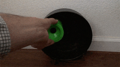

I thought the only relevant instant is when the wheel strikes the pan. A mass (the skateboard wheel) has kinetic energy, transferring some of the energy to the pan. The pan has to roll.
metastable said:
I thought the only relevant instant is when the wheel strikes the pan. A mass has kinetic energy, transferring some of the energy to the pan. The pan has to roll.
Regardless, the two above-mentioned factors are relevant.
( 1] That is not a closed system. 2] It does not have a homogenous density. )

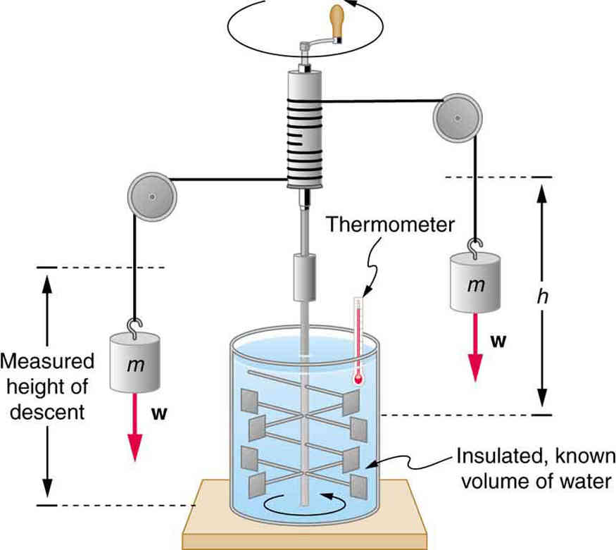

Even if the fish has the same density, wouldn't the mass of the overall fish relative to the mass of each water molecule at least somewhat factor into the equation? Some of the motion of the water molecules has to turn into heat instead of recoil.
metastable said:
Now, you're just being silly. Unless you have COMPLETELY changed what we are talking about here.
Can we agree if the fish swims directly from the bottom to the top, all of the motion it causes in the water molecules from swimming through the water will eventually be converted to heat and radiated to the environment? Are you saying this process won't also occur if the fish swims downward at a slight angle and forcefully knocks into a point beside where the ball makes ground contact?
