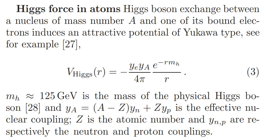

Actually, by its very construction the standard model incorporates an ultra-short-distance Yukawa force between leptons and quarks arising from the exchange of virtual Higgs bosons. See, for example Probing Atomic Higgs-like Forces at the Precision Frontier:
The characteristic range distance of the force potential (3) is ##d=\hbar c/M_H=1.58\times 10^{-18}\,\text{m}\,##. Note that ##d## is only about ##1/500\text{-th}## the radius of a proton.
But this is not due to the Higgs VEV, let alone a gradient in it; the VEV is constant and has no effect on the dynamics you're describing here. The Higgs bosons are what is "left over" after the VEV is determined at the electroweak phase transition.
I certainly agree with you regarding the Higgs VEV. In my defense, my post was written in response to the title of the thread: "Can a Higgs Field Gradient Produce a Force?" (italics added by me). Clearly the answer is yes.

Can you clarify your response? You mention gauge bosons (spin-1), but Higgs bosons are massive scalar (spin 0) particles which, to my understanding, always give rise to an attractive gradient force, just as in the original nuclear binding model of Yukawa based on the exchange of massive pions.
I don't think an even spin exchange interaction has to be attractive--I think in the even spin case like charges attract and unlike charges repel, whereas in the odd spin case, like charges repel and unlike charges attract. In the case of the Higgs interaction you describe, the "charges" are basically the masses (or at least the mass numbers), so it's all like charges, hence an attractive interaction.
