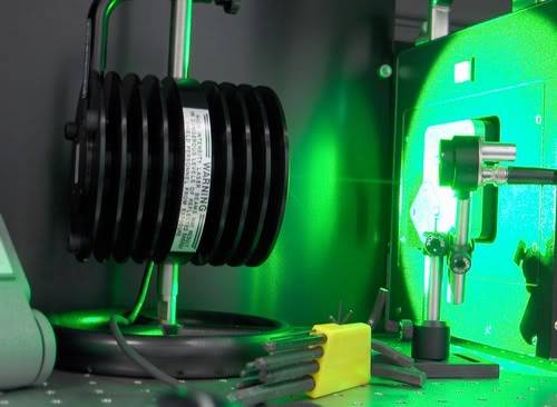

Can you see a laser beam?
Obviously.
The laser in on the right, to the left is a power meter, the intense green circle of light on the laser is reflected from the power meter. In between the laser and the power meter is a PIN diode used to measure pulse width from light reflected off of the power meter.
This is 30W Coherent laser.
Sure, this is trivial. But the question was whether one can see it moving.
