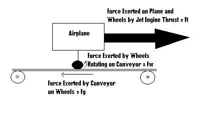

So I have heard this around the internet before but thought is was a question worth exploring if a jet plane is sitting on a treadmill and the treadmill moves backwards at the same rate the plane is moving forward will it take off? I think no because the plane would have to be moving forward for air to go over the wings to provide lift right? unfortunately there is a lot that disagree with me and was wondering if I could get a reply from some more qualified people. (sorry if there is ignorance in this post I still haven't started under grad physics yet)
  • Diagram of an airplane on a moving conveyor: jet engine thrust Ft pushes the plane forward, wheels rotating on the conveyor exert force Fw, and the conveyor exerts force Fg on the wheels, which points backward.

sorry for any vagueness I added a diagram that can probably explain it better than me
The diagram shows three forces. The thrust force is obvious. What is the cause of the other two?
russ_watters said:
How? What is the cause of the force in your diagram?
the conveyor turns in the opposite direction of the thrust force of the plane. The plane is sitting on a conveyor belt
I know the conveyor moves and the wheels spin, but motion is not force. Indeed, in constat speed motion, forces must sum to zero. So what causes the forces? Consider that the spinning wheels don't stop a plane from taking off on a runway, so ordinarily there is essentially no force exchange between runway and wheels. Why does the conveyor change that?

The planes tires will spin twice as fast, which won't have much effect on the plane accelerating forwards due to thrust, and the plane will be able to take off, only using bit more distance to compensate for the relatively small increase in angular kinetic energy of the wheels.
The TV show myth busters did an actual demonstration, by pulling a "conveyor belt" backwards:
rcgldr said:
Going back to the original question.
This is fine for your, my and Mythbusters' assumptions, but fails for the OP's assumptions, which define the plane to be at rest and include other necessary assumptions like an engine at idle.
If the aircraft has wheels there is very little or no friction between the aircraft and the conveyor belt. So the moving conveyor belt applies very little rearward force on the aircraft. This force is easily overcome by the thrust from the engine so the plane accelerates and takes of normally.
The only difference is that the wheels rotate faster.
If in doubt draw a free body diagram of the aircraft showing the force acting on it.
