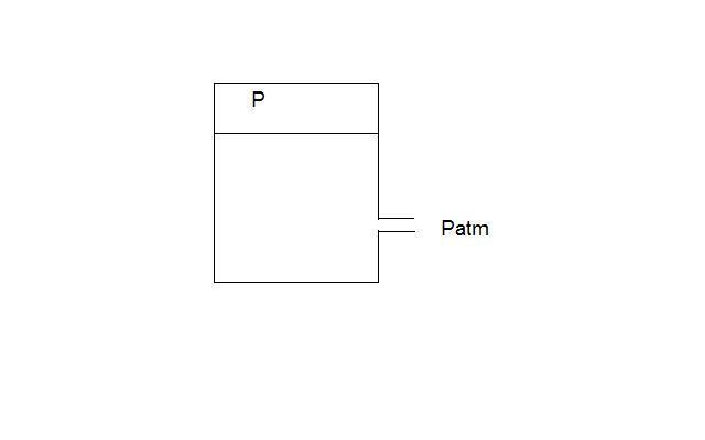

This question is a product of my own mind-
Refer Figure.
Suppose the value of P= 2Patm, can 2Patm fall to Patm before the liquid levels with the hole-level? In other words, can there be a liquid column above the hole?

It is possible. When the volume of the space above the liquid doubles, pressure becomes Patm.. Still there is a water column above the hole. As the water drains, pressure above the water decreases below Patm. At one level above the hole, the sum of the pressure due to the water level above the hole and pressure in the space above the water may become equal to Patm.
