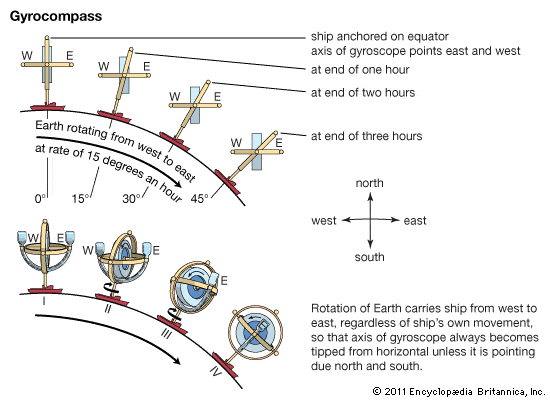

Hi

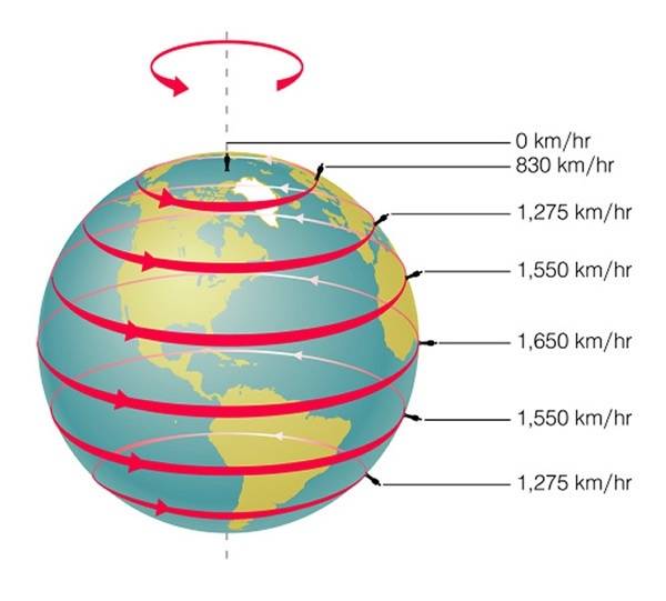

is there any device or experiment, which could measure Earth spin vector and magnitude, centrifugal/centripetal forces, so i could derive from it, where is west and east , what's the vector of Earth rotation and what's my lattitude.
Im assuming these forces and effects has to be measurable with todays technology.
the device will be stationary, non moving( car, aeroplane), without external referencing, celestial objects,etc...

Trouble with a gyroscope is it needs to be set up and aligned, so i don't think it can measure the eart's rotation axis.

i tried with precision gyroscope, did not work,did not move, i guess too much internal friction in joints

I meant device without referencing celestial objects, just blindly measuring forces and vectors ( inside the box)
gravity and the rotational forces overlap, that's true but on poles rotational forces should be zero and at equator should be max, so has to be measurable difference there, from which lattitude could be derived

A gyroscope measures what happens when you move.
That would only be true if the gravitational component of the force were constant, which it isn't.
yes groscope disk should change angle relative to base, since gyroscope base is moving with earth, but no angle change for me

How far did you move?
once spun to max revolutions, it took 27 minutes for the disk to stop, i know it needs high rpm all the time, but should move at least few degrees
7.5 degress in 30 minutes, if all was by the book

What direction was the axis pointed?
of course i tried all possible angles and orientations, nothing happened
You can use a Foucault pendulum to measure your latitude.
A ring laser interferometer will be more reliable than a gyroscope, particularly since it sounds like your gimbal has sticky bearings.
