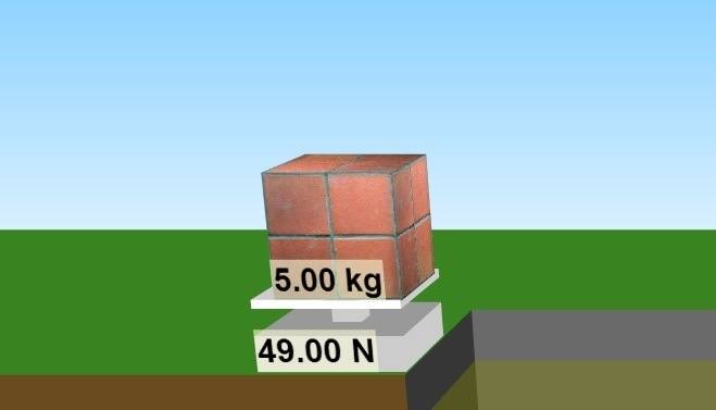

Imagine red box as a fully enclosed device powered by electricity
when turned off, it weighs 5kg, it is pushing down with force cca 49 Newtons
when turned on, it would weight more, let's say 6kg, pushing down with force cca 58.86 Newtons
is it in theory possible to make such device, increasing its weight continuously in the direction of gravity ?
Not continuously. That would break Newton's laws. You could put a vertically oscillating mass inside but the average weight would be the same.

There is not. Unless you add mass to the box from outside of this system, then there is no way for its weight to increase.

Yes, if you pump energy into it, you can increase its mass: E=mc2

To clarify for the OP, this energy must come from outside of the box or it would already be included in the boxes mass.
Right, If "fully enclosed" means powered by energy already stored inside, then it won't work.

e=mc^2 works both ways: mass has energy and energy has mass.

The equation does not have any such caveats. Energy has mass. Period. If you increase the energy in the box, its mass goes up.

I don't think you do understand, because you are contradicting yourself and me. E=mc^2 is for all types of energy, including electrical energy. It has no caveats specifying what type of energy it works for.
Note also, the OP does not describe if any kind of energy conversion exists in the device. It may be a flywheel spinning-up or it may be a battery or it may just be getting hot. Regardless of what type of energy it stores, E=mc^2 works the same way.

Energy is energy, as Russ said. If you store more and more energy in the box, the mass of the box will increase.

Adding electrical energy as you like, still you can't make such a device, you need A LOT, yes A LOT of energy to be able to make few grams, unless you power it with bunch if nuclear reactors, electric energy is motion if charged particle, these charges move inside the box, so E = mc^2 would work here, and the box can catch up some electrons but again you'll never be able to add kgs,so sorry for disappointement !
I guess you could arrange things so that your red box has an ion drive attached to the top of it, powered by the boxes internal battery.
While drive is operational it would provide an acceleration in addition to gravity this increasing the apparent weight.
However once the ion drive is turned off the box should be lighter than it was previously since some of it's mass (the engine propellant) will have been lost,
The point is the red box is a sealed system so the ions could not escape. If you remove that restriction you could strap anything on the top like a liquid fuel rocket, grasshopper trap, rainwater collector...
