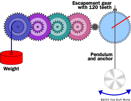

What i am basically trying to do is to raise a weight and then bring it down slowly. I am not sure how to go about this. Any tips towards this design goals i appreciated
A weight can be lowered slowly using something like this:
Diagram of a weight-driven clock train: a hanging red weight on a cord wraps a large blue gear, followed by a chain of meshing gears leading to a blue escapement gear with 120 teeth, a pendulum and anchor below.
From http://electronics.howstuffworks.com/gadgets/clocks-watches/clock4.htm
and for more detail scroll about halfway down http://electronics.howstuffworks.com/gadgets/clocks-watches/clock3.htm"
