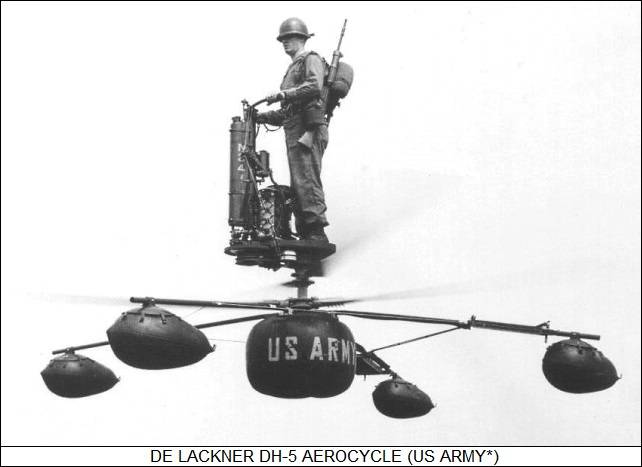

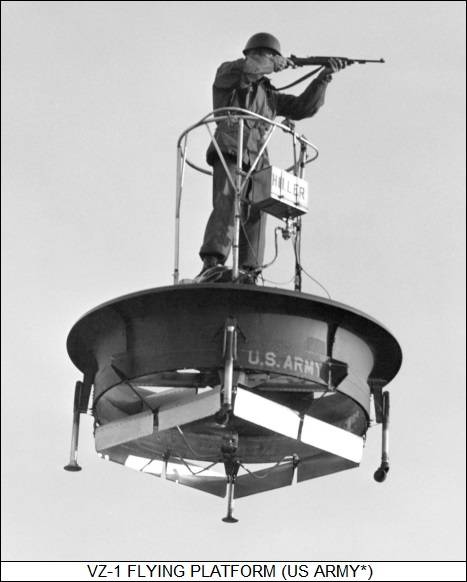

The US Army played with this concept in the 1950s. Maybe they gave up because of too many close shaves?
Black-and-white photo of a soldier in a helmet standing on the platform of the De Lackner DH-5 Aerocycle, a single-rotor hovering craft with a rotor overhead and pod-shaped fuel tanks on outrigger arms; the body reads US ARMY and the caption reads DE LACKNER DH-5 AEROCYCLE (US ARMY*).
Black and white photo of a soldier in a helmet aiming a rifle while standing on the open railed deck of a circular VZ-1 flying platform, with US ARMY printed on its disc-shaped body.
