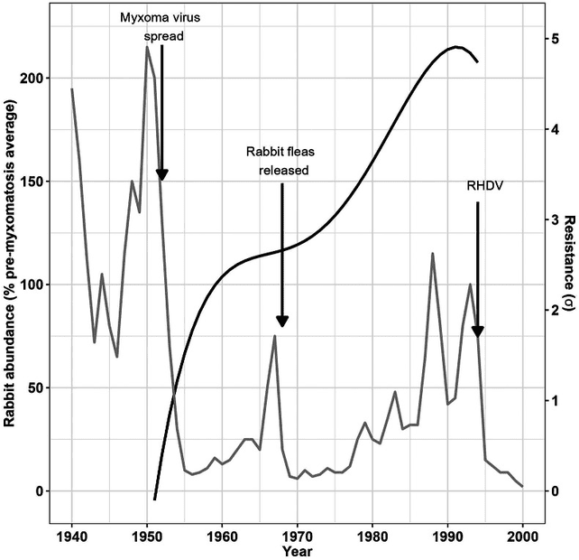

  • #36
bhobba said:
Myxomatosis has done a good job.
Really? Maybe, sort of...
An external file that holds a picture, illustration, etc.Object name is S0950268823001668_fig3.jpg
Figure 3.
Rabbit population size in relation to rabbit resistance to myxomatosis.
The build-up of resistance to myxomatosis in wild rabbits in Australia (solid black line) explains the partial recovery of the rabbit population (grey line) following the initial introduction of the myxoma virus and the subsequent introduction of European rabbit fleas before the introduction of rabbit haemorrhagic disease virus (RHDV) again reduced rabbit abundance.
https://www.ncbi.nlm.nih.gov/pmc/articles/PMC10644057/#:~:text=Resistance increased in association with,resistance became common after 1975.

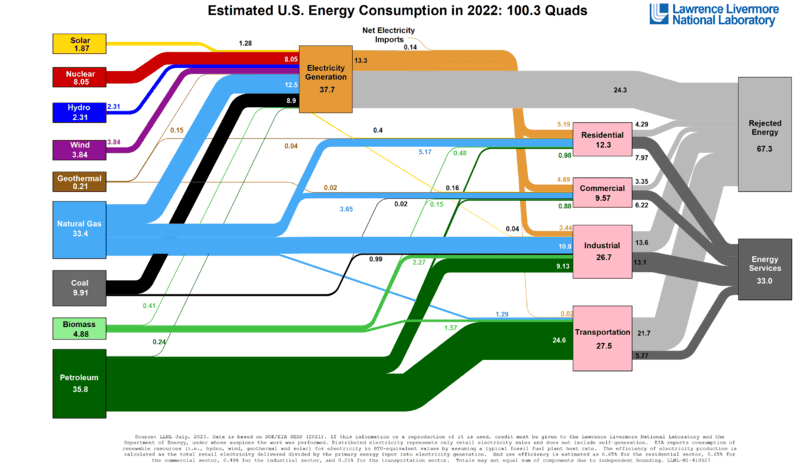

Google says that Australians use about the energy equivalent of about 5500 kg of oil per year. It also tells me that oil is about 12 kWhr per kg. So an Australian needs roughly 66,000 kWhr of energy per year.
If you were strictly relying on solar and storage, and make the assumption of 3000 hours of sunlight per year, then it takes 22 kW of solar panels per Australian. A typical solar panel is 15% efficient, and the solar constant is about 1.3 kW/m^2, so one Australian needs about 110 square meters of solar panels.
Call it 26 million Aussies. That is then 2,860,000,000 m^2. or about 3000 square kilometers of solar panels. Australia is 7.7 million square kilometers in area. So less than 0.4% of Australia would need solar panels. Then of course storage.
I would say that it is not a pipe dream. The use of other renewable sources such as wind, tide, geothermal, and hydroelectric also add to the potential energy sourcing.
Obviously storage is required if you have production asynchronous with use.
Can you provide a link or source for this? It is not clear to me what is included here. 66,000 kW-hr per year is an average of about 7.5 kW (66000/365/24) per Aussie. US home electric use is ~0.75 kW per dwelling. So there's a lot more in that 66,000 than just that. What's included and what conversion efficiency is assumed?

I assume the per capita energy use includes industrial and commercial use, which dwarf home use.
I googled: australia per capita energy consumption
The "answer" in my search results is putatively from the World Bank. (5,483.82 kg of oil equivalent (2015)).
Commercial power use HAS to be included in any National energy consideration. I also assume transportation is included. Anyone driving knows they use a LOT of liters of refined gasoline per year.
I don't know the efficiency ... I simply googled. Here is a new google result: https://www.unitconverters.net/energy/fuel-oil-equivalent-kiloliter-to-kilowatt-hour.htm
I'm not trivializing the effort or cost. I am simply mentioning that energy storage alternatives to batteries exist. I do recognize there are many limits on pumped hydro energy storage. I did not mean to imply it was free and perfect.
Energy infrastructure is expensive in almost any form. The Raccoon Mountain Facility you point to has a 1.6 megawatt capacity for 22 hours. It is economically viable energy storage ... but not trivial.
My back-of-the-envelope calculations were to determine if it was a pipe dream or not. The simple calculation is that there is adequate solar energy potential to meet Australian energy demand in aggregate. If there is a factor missing to get more accurate calculation ... definitely include that.
The "US per capita energy consumption" search result is 6804 kg of oil equivalent.
