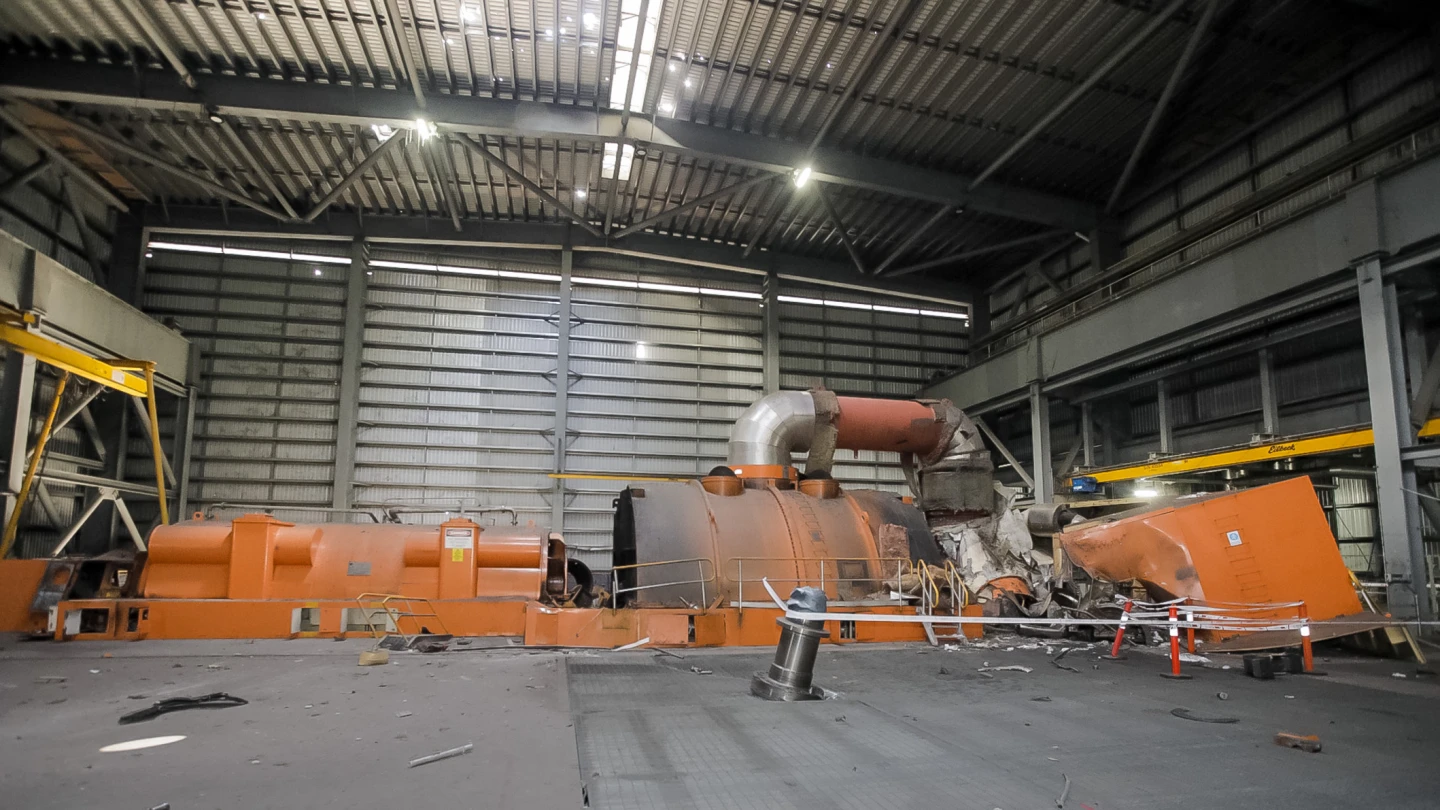

Although far from all he did, he has quoted for several coal power plants and knew their design intimately.
Where I grew up, we were near the Tennyson power plant in Brisbane (now the Queensland Tennis Centre), and I don't know why, but as a kid, I asked Dad what dangers were there near a power plant. He said it was very well engineered, had regular maintenance, and was unlikely to happen, but if the bearing on the turbine broke, watch out; he couldn't see much of anything withstanding its path of destruction. Knowledge makes you a bit paranoid, but he wasn't unhappy when we moved further away.
It happened at the Calide Power Station (investigators are still not 100% sure of the cause but Turbine failure is a leading contender) - please take a look at the attachment.
The general public doesn't know the dangers or, if they did, how to put it in context using stats. The following course examines why this is, amongst other things like why some believe in Astrology, Homeopathy, etc. Its quite interesting:
