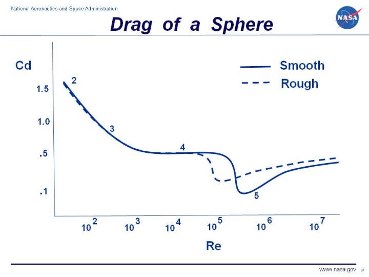

Hi David. I guess I'll have to disagree with the responces so far. I don’t have a calculator to do real cars, only for cylinders and spheres so I did a calculation for a cylinder driving down the road. Something like this:
Drag is linearly dependent on density so if you heat the air by 1%, density decreases by 1% and drag also drops by 1%. See for example:
http://exploration.grc.nasa.gov/education/rocket/drageq.html
As Boneh3ad points out though, viscosity increases with an increase in temperature. This gets into the calculation through the coefficient of drag which changes as a function of Reynolds number. See this graph for example:
As temperature increases, viscosity increases, Reynolds number decreases and coefficient of drag increases so drag force increases. But the affect is very small. The affect of gas density is much more significant. Doing a calculation for Fred’s car, I find the drag is linearly proportional to absolute temperature.

Here's the problem with this assessment: the drag equation you are using to make this conclusion depends on the free-stream density, not the density in the boundary layer. The exhaust gas will only affect the very thin layer of air by the car, so drag is not going to vary linearly (or even hardly at all) with that density change in the boundary layer.
The primary effects will be viscous in nature, in which case the likely result is greater viscosity and a tripped boundary layer if it isn't already turbulent at the injection point, both of which increase drag. Also, while a turbulent boundary layer can reduce drag if it's effect on drag due to separation is larger than its effect on viscous drag, on a car the boundary layer is likely turbulent before reaching any separation point anyway. So there's no benefit there.
On the other hand, if you injected the air parallel to the wall just upstream of the separation point at the rear of the car, you can probably delay separation a bit if the separation point is in a location amenable to this approach. In that case it may be possible to reduce drag. It probably wouldn't work if the separation point is already so far back that it occurs at the sharp corner near the trunk, though.
