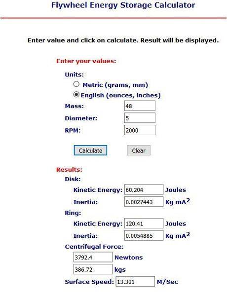

@ Om, I really am thankful for all your input and research :smile: But I just don't understand how your measurements are calculated. The time is confusing to me, as I see complete cycles from zero to maximum and back to zero in about 10 seconds, the speeds seem to be very fast ( I would say close to 2000 rpm o_O ) if I'm right, here is a calculator for showing my little 3 pound flywheel.
http://www.calculatoredge.com/mech/flywheel.htm
Guess my numbers don't show :mad: I used 48 oz. 5" dia. and 2000 rpm. (just guessing at speed, which is very momentary)
Maximum angular velocity was 185.4 rpm @ t=4.5 seconds.
Uh oh. My numbers don't match.
Ah ha!
I used the moment of inertia of 10 disks vs 1 disk.
My "real" numbers may have been off for the last few days.
:redface:
My searching has taken me to a book that is Greek to me " Vector Mechanics for Engineers" an 84 edition. (nothing I can see that looks close):confused:
I think it's time to start the slow contemplating process for my three pound wheel ( don't hold your breath :nb) )
I,ll get back later.
RonL ... I don't mean to butt in here, and it might be a fact that...
If you don't know what you're talking about, then I prefer you don't say anything about this at all.
But, I think you about have to take a screen grab to keep your numbers showing... I input the same numbers as I bolded in your quote. Is this what it showed... ?
BTW... nifty calculator.... :oldcool:
That is what mine showed, thanks and anyone is welcome to have a say :smile: especially if they can help show how the linear force is transferred through the twisted section. ( I feel there is very little loss there)

Om, I made a few test today, but I had no way to absorb energy from the flywheel so I had to be extra careful not to spin things too fast.
The flywheel weighs 4 pounds and 7 ounces. It is 5" in diameter and is 1/2" thick. The axle part is a 1" diameter and 6" long.
I used a two strand Kevlar thread on each side (400 pound test) about 1/8" thick.
I suspended it like you did the CD disk, from a 2X4 and applied energy with a 2 X 2, the distance between them was 50" and the string measure on each side 22"
Cycle time was right at 17 seconds, 85 twist to full stop and the digital tach shows 975 to 1025 rpm, the variation had to do with my unsteady applying of pressure by hand, which I would estimate at about 2 pounds pushing down on the 2 X 2.
The take up of line distance surprised me, a total of 13" at which the travel was limited by the scaffold frame and the fan of the string would absorb the rest of the spin motion.
A lot of numbers, I'll try to make better order of them later.
Hope you have a good week end.:cool:

That moment of cogging you mentioned, seems to be a real energy killer, I tried putting a few twist in the upper section before sliding the string over the 2 X 2 at the bottom, that eliminated the bump, as twist went from one direction to the other, but it seemed to cripple the input of power (not sure exactly what was happening).
I'm beginning to think, the piston chamber area needs to function more along the lines of a sterling cycle. But that is a long way off.
Still think my drawing is close to accurate, just need some very good energy absorbing controls that are precise and easy to adjust during operation.
I was very happy to see the speed of the flywheel hit that 1,000 rpm mark, That flywheel speed is the very heart of what I'm thinking, but my footing the bill for special prototyping is not very likely.:frown:
Basically our test setups are almost alike, mine is lifting close to seven pounds, thirteen inches and when it reaches the cross brace of the scaffold and the 2 X 2 can't go any higher, the string and fan area act like a spring, sending the flywheel in the opposite direction. ( that 400 pound test, Kevlar is pretty good stuff) :cool:
