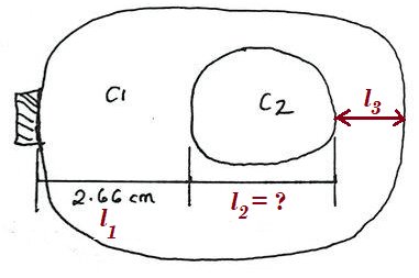

nao113 said:
Here is my full answer.. do you agree with me? Thank you
I agree with these. However, there is another case that you have missed.
  • #32
May I know what is it?
  • #33
I don't want to give it away. It is not a very complicated path. Try playing around with various paths.
  • #34

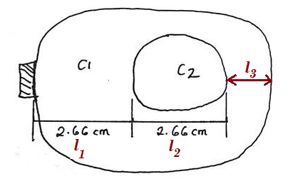

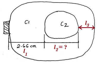

nao113 said:
Yes, I just realized it will produced 38.4. is there any formula to recreate another anatomical configurations? Can you explain more about what should I have to do? Here, I tried another one, is it correct?
This will produce the echos at 34.5 μs and 69.0 μs. It will not produce the 73.2 μs echo unless the distance ##l_3 = 0.32## cm. But you already discovered that case.
What if you choose ##l_2## to be something other than 2.66 cm?
Can you choose it so that you get echos at 34.5 μs, 69.0 μs, and 73.2 μs and no other echos with arrival times less than about 75 μs?
  • #35
Sure, I ll try to find other paths, thank you very much
  • #36
I see, I got it, I will try another distance which match with the given echoes, thank you so much
