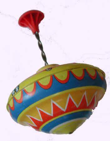

I had this as a kid. You push on the plunger to spin the bottom part. But if the spinner is fixed while the plunger is free to rotate it will rotate, because there are equal but opposite torques. Note the high thread pitch.

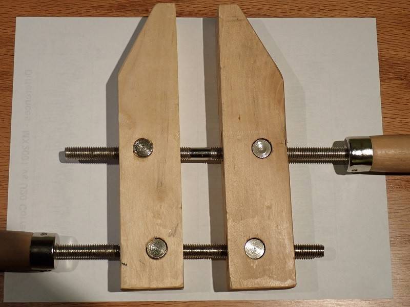

Some screws are not supposed to back drive, but do anyway. I have a pair of hand screw clamps with double lead screws. The screws are 3/8" diameter. The threads look like 16 threads per inch, but have 1/8" lead (8 turns per inch of travel). After I lubricated the screws to stop them from squeaking, the clamps stopped clamping. I tighten the clamp, and the screws unscrew by themselves. Not enough friction to work correctly.
I tried to clean off the lubricant with solvent, but have had only partial success. The clamps will hold, but with only light clamping force.

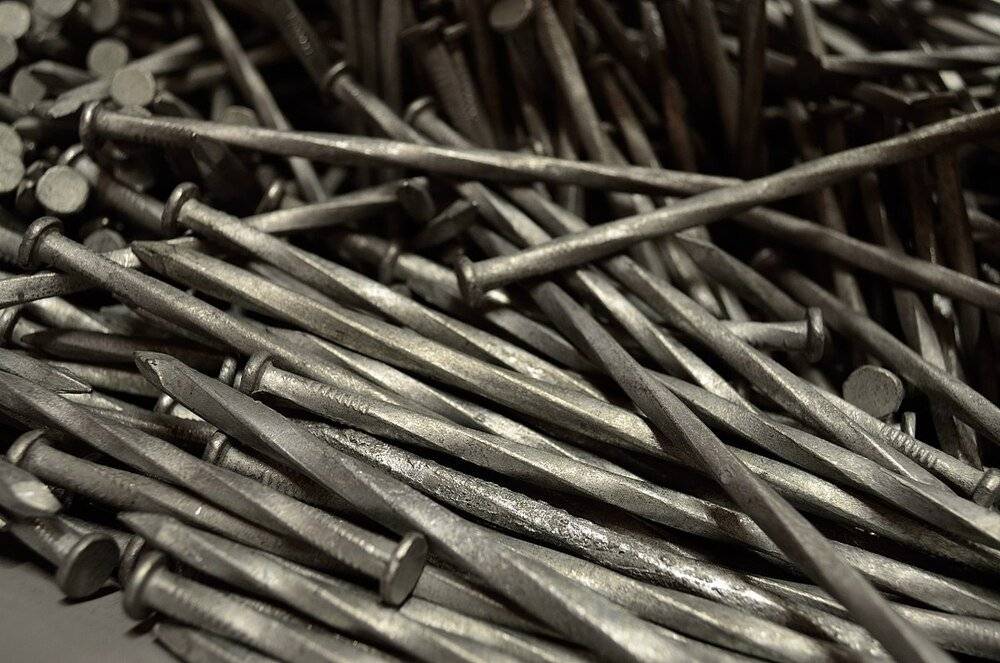

The best example that an axial force on any propeller can be converted into torque is a wind power generator, or a hydroelectric power plant turbine, that the material is a solid such as wood, plastic, sheet metal, etc. instead of a fluid, not it influences the physical principle that makes it possible.
Take a photo after each hammer blow on the nail head of message # 21, and you will see how a small angle rotates as it penetrates the material, there is a linear relationship between the impact force and the rotated angle, the variables are the coefficient of friction and the angle of the thread.
