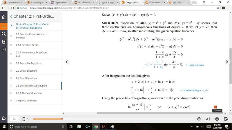

Attached is a picture..
the book went from
[itex](-1 + \frac {2}{1+u} ) du + \frac {dx}{x} = 0[/itex]
Edited by moderator.
to
[itex]-u + 2ln(1+u) + ln(x) = ln(c)[/itex]
How in the world could the integral of 0 be ln(c)?
Maybe because it's 5 am and I'm up late and I'm hallucinating, but I always thought the integral of 0 is c, just a constant.
taking the integral of
[itex](-1 \frac {2}{1+u} ) du + \frac {dx}{x} = 0[/itex]
I get
[itex](-u + 2 ln(u+1) + c ) + ln(x) + c_2 = c_3[/itex]
[itex]-u +2ln(u+1) + ln(x) = c_4[/itex]
It is an integration constant ...
Edit: And you seem to be getting exactly the same so I do not see what the problem is ...
Edit 2: Obviously, the logarithm of a constant is a constant ...

I understand that but why not just write K or whatever, why include ln? Like where did ln come from? They later use properties of logarithms to write
[itex]\frac yx = ln(\frac {(x+y)^2}{cx})[/itex] so I need to know where the ln(c) came from..
I mean I guess it makes sense since ln(c) is just a constant... I guess I've just never seen anything like this before so its new to me..
You can use either ##c## or ##\ln(c)##, it makes absolutely no difference - both are arbitrary constants. The reason they chose ##\ln(c)## is that they could take it inside the logarithm when simplifying their expression. Again, the expressions are completely equivalent.
Gotcha. I mean it makes sense now that I think about it... thank you brother.
