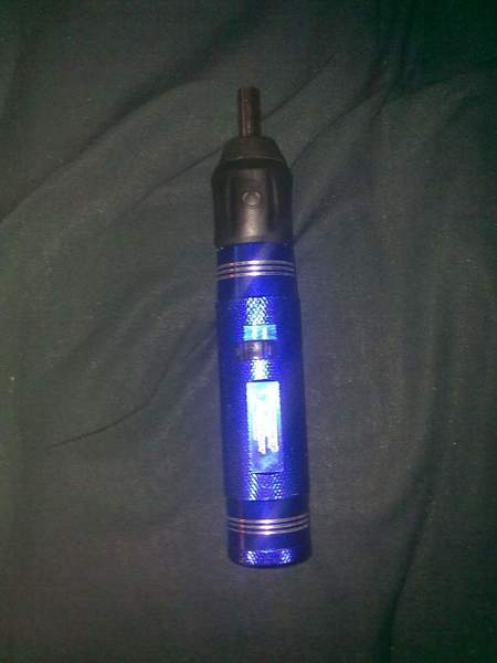

This is actually very interesting. I must consider myself a big Doctor Who fan myself, but I don't have a tremendous knowledge in Physics - I'm still learning at this point. :) But I would really like to build something like this, a device that uses sonic waves to perform actions such as loosening screws. I've read through this entire thread, but as I'm still quite new to physics, I'd greatly appreciate a little help with this topic. Does anyone have any handy tips or a simple guide or steps for me to follow to achieve this?
As I said, I'm looking to design a simple device at this point, so thanks for any help! :D

I don't know about the Doctor's current screwdriver with 29 computers built into it, but his earlier designs were as simple as they can come; Electronics 101 kind of stuff-- 2 easy to get IC chips (XR2206 function generator and CD4046 PPL chip) and a handful of small parts, basically. The design doesn't include the battery converter, which I consider a separate system.
1. The XR2206 generates a variable frequency sine wave and requires 3 resistors, a capacitor, and a pot.
2. CD4046 configured as a VCO (voltage-controlled oscillator) needs two caps, a resistor, and a pot. This is really simple.
3. A resistor connects the sine wave oscillator to the VCO; a couple of resistors connect a pair of transistors and a [miniature] transformer in a push-pull amplifier to drive a ceramic transducer. It's really harder to describe than it is to build.
I had designed the entire screwdriver using Turbo-CAD, an inexpensive but sophisticated CAD package. But when my laptop crashed, all of my files went with it. Fortunately I had paper printouts for machinists to make the outer casing, which isn't simple at all. I had taken drafting and machine shop in high school, but I don't have the kind of machine lathe to cut out the separate parts of the casing
The Romana-screwdriver is nothing more than a 15 kHz power oscillator. It works, but it lacks the style and elegance of the Doctor's screwdriver. :-)

Hi Doc! :)
Thanks for your prompt response. I actually like the previous sonic screwdriver models, as apposed to the current one. And if I am to create one, I would base it off the previous model.
So, to build the screwdriver - I would just require all of the components you've listed above? And then I just piece it all together?
Thanks again!

I totally agree I have been pondering and pondering how when I finish building this how cool it will look plus when I pull it out at a job and people ask what is that? I'll be like it's my Sonic Screwdriver :P
  • #88
I'm building a casing for a sonic and I really need a brain for it (ie. the schematics/parts list)
It'll be a mix of Tennant and Smith screwdriver
That screwdriver does everyting but make coffee! Mine only turns screws-- and the occasional dinner plates... :-)
'Doc
