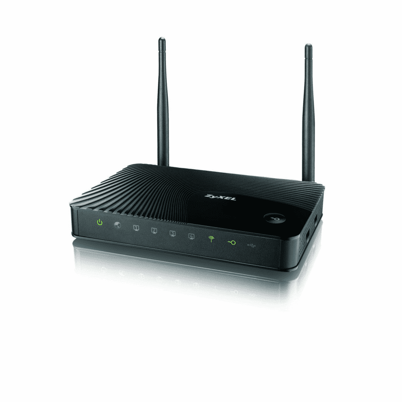

Do you know what frequency this radio is tuned to when this happens? The human body definitely affects WiFi signals in the 2.4GHz band, and also in other radio bands (2 meter, 70 centimeter HAM radio bands, for example).
Generally that would have to do with the polarization of the EM waves in the radio signal. Vertical and Horizontal are the two most common polarization types/directions.
The Radio signal is 97.6 MHz. I am wondering that after so many reflections incurred during traveling from the broadcast station to my home, the magnitude in both horizontal and vertical polarization is roughly the same.
It is true that reflections from some angled surfaces can rotate the angle of polarization, and multi-path signals can create nulls where the multiple signals destructively interfere, leaving very little net signal to be picked up by the receiving antenna. That's the main reason for the "antenna spatial diversity" that you see on some WiFi Routers and other RF devices that use frequencies and are used in environments where multipath is a big issue. If one of the antennas is in a receiving null due to multipath interference, the other one generally will not be in a null.

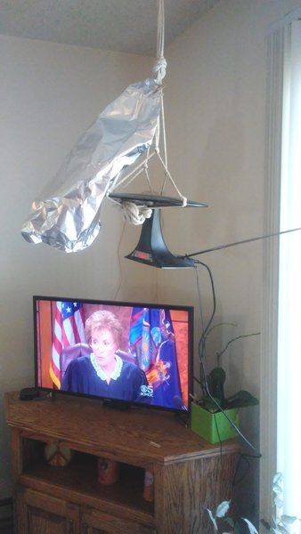

I posted a thread a while back about my Digitial TV antenna/receiver hacks... :wink:
berkeman said:
So the quality of my over-the-air digital TV reception has been getting worse over the past few months. Probably the digital TV antenna that I'm using is getting old and starting to degrade. Last night I resorted to trying different reflector combinations to try to boost the signal for the horizontal UHF dipole antenna (inside the rotator disc on the top of the antenna unit). I could hand-hold it in a reasonable reflector position, but it was hard to figure out a way to mount it permanently.
So I went the fractal reflector route shown in the picture below (the antenna unit was already hanging from the ceiling). It actually worked a lot better than I expected, but it probably won't work for all stations (since you have to use the rotation function to find the best direction to point the UHF dipole in the disc -- the local stations are spread through about a 90 degree arc to my north.
Anyway, it looks like it's time to spring for a new over-the-air digital TV antenna. We live in a 2nd floor apartment and the TV is next to the balcony, so I could probably camouflage a fairly large antenna below the railing if that would help. (I already have a camouflage HAM radio antenna on the balcony). Does anybody have any suggestions for good digital TV antennas (USA models)? Clearly it needs to have rotational capability (or phased array capability, if that exists for digital TV antennas).
Thanks for any ideas! :smile:
