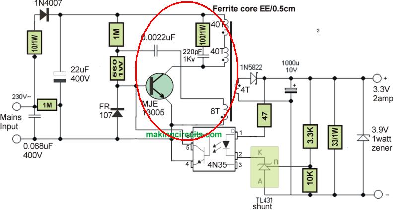

Now I'm checking the "switched-mode power supply" here https://en.wikipedia.org/wiki/Switched-mode_power_supply and I'm looking which process causes interfering electromagnetic emission. Do you know what is it?
mostly from the high voltage switching side and assoc. windings of the transformer
as I have circled...
as I have circled... View attachment 276537
Ok, thank you!
Why isn't it constant interference? Why is it periodical?
I imagine the charger is intelligent and is cycling the charge on and off.
