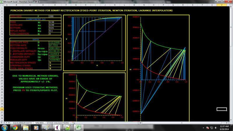

So this is what I have now...
I'm trying to make a PS distillation method spreadsheet that would work with that VLE generator.
So far, this is what I have. It's working now, except it iterates until tens of thousands (good-bye computer memory e.e)

I don't quite understand the question. To test your PS implementation, you should run a case where the McCabe Thiele method give a good approximation. Then you should solve the problem both ways and compare the results. Once you are satisfied that the implementation works for such a case, you can start looking at cases where MT is not expected to do a very accurate job.
As far as your immediate problem is concerned, have you tried to run the calculation with a higher reflux ratio? Does the problem persist? Maybe you are running too close to the minimum reflux ratio, in which case you would have an excessive number of plates.

Yep, it happens when I run very low reflux ratios. Maybe it passed through the minimum reflux already. :|
