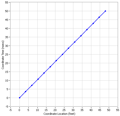

No observer ever sees anything differently just because you (or he) uses a different reference frame to describe what's going on. All that changes are the coordinates assigned to each event.
Here's a diagram for an observer that is stationary in an Inertial Reference Frame (sometimes referred to as his rest frame):
The observer is shown in blue and is stationary at the coordinate location of 0. The progress of his clock marking off his Proper Time is shown by the blue dots. Since he is stationary in this IRF, his Proper Time is not dilated, meaning that it progresses the same as the Coordinate Time marked off by the horizontal grid lines.
Now we transform this IRF into one moving to the left at 0.96c:
Now we see that the observer's location is changing and the progress of his Proper Time is dilated with respect to the Coordinate Time. In other words, it takes more Coordinate Time for his clock to progress through the same amount of time as before which makes his clock tick slower in this frame. All I'm trying to show you is that his clock runs slower and his distance is larger. Isn't that what you were asking about?
However, keep in mind that the observer has absolutely no awareness of anything different in these two frames or any other frame. There is no observation, no measurement, nothing that he can see differently just because we use different frames to describe or analyze what is going on in any scenario. All the changes caused by different frames are 100% coordinate effects.
