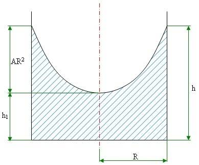

The angular velocity is ω, R is the radius of the vessel. at rest the water has depth H.
The face of the water form a paraboloid y=Ax2. find R for which the maximum height h of the water above the bottom doesn't depend on ω.
Centripetal force: ##F=m \omega^2 r##
The function of the water face is:
$$y=\frac{\omega^2}{2g}r^2$$
The volume under the paraboloid is ##V=\frac{\pi A}{2}R^4=\frac{\pi\omega^2}{2g}R^4##
The height of the highest point from the bottom, h, is derived from the difference between the volume at rest and the volume under the paraboloid:
$$\Delta V=\pi R^2 H-\frac{\pi\omega^2}{2g}R^4=\pi R^2 h\;\rightarrow\; h=H-\frac{\omega^2 R^2}{2g}R^2$$
If ##R^2=\frac{1}{\omega^2}## they cancel and ##h=H-\frac{1}{2g}## which doesn't include ω.

I made a mistake in calculating h but now no better:
$$\pi R^2H=\frac{\pi\omega^2}{2g}R^4+\pi R^2h_1\;\rightarrow\; h_1=H-\frac{\omega^2R^2}{2g}$$
$$h=h_1+AR^2=H-\frac{\omega^2R^2}{2g}+\frac{\omega^2}{2g}R^2=H$$

Of course h≠H but how? i don't get ##h=H+\frac{ω^2R^2}{2g}##, and if
Is correct then i don't know how to reach it, and if i don't get the right expression for h i have difficulty thinking further.

In your post #5, how did you get the value of AR2? (I believe it is double the value you substituted.)
I agree with your expression for the volume under the paraboloid. Interestingly, it is also the volume above it, i.e. it is half the volume of the enclosing cylinder.
Karol said:
$$\pi R^2H=\frac{\pi\omega^2}{4g}R^4+\pi R^2h_1\;\rightarrow\; h_1=H-\frac{\omega^4R^2}{4g}$$
$$h=h_1+AR^2=H-\frac{\omega^4R^2}{4g}+\frac{\omega^2}{2g}R^2=H+\frac{\omega^4R^2}{4g}$$

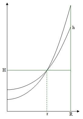

Maybe my use of h there is confusing you. Let's use x and y.
Let y=y(x) be the height of the surface at radius x. Can you find an x such that y does not depend on omega?
And at that x, if i change ω won't y change? i mean, is that a "point" x?
It's a certain radius, yes. If you imagine the water profile as the rotation rate increases, it will dip in the middle and rise at the sides. So any two given profiles must intersect at some radius. The question is, is it the same radius all the time?
$$h=h_1+AR^2=H+\frac{\omega^2R^2}{4g}\;\rightarrow\; y_1=h_1+A_1x^2,\;y_2=h_2+A_2x^2$$
$$y_1=y_2:\;h_1+A_1x^2=h_2+A_2x^2\;\rightarrow\; x=\frac{\sqrt{2}}{2}$$
$$y_1=h_1+A_1\frac{1}{2}=H,\;y_2=H$$
Karol said:
View attachment 93268 $$h=h_1+AR^2=H+\frac{\omega^2R^2}{4g}\;\rightarrow\; y_1=h_1+A_1x^2,\;y_2=h_2+A_2x^2$$
Looks good.

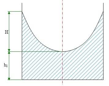

At this ω0 the bottle is placed on a smooth table. there is friction between the water and the bottle. the final angular velocity of the bottle is ω1. express it using ω0. it's given that at this stage the height difference between the highest and lowest points on the water surface is H.
what's the moment of inertia of the bottle.
I found the moment of inertia of the water at ω0 to be:
$$I_0=\pi \frac{\rho \omega_0^2 R^6}{6g}=\frac{2}{3} \pi \rho HR^4$$
From ##y=Ar^2## i find ω1:
$$H=\frac{\omega_1^2}{2g}R^2\;\rightarrow\; \omega_1^2=\frac{2gH}{R^2}$$
I want to find h1. from the formula in post #9:
$$h_1=H-\frac{\omega_1^4R^2}{4g}=...=\frac{H}{2}$$
The moment of inertia of a solid cylinder: ##I=\frac{1}{2}mr^2##
The moment of inertia of the paraboloid+the cylinder:
$$I_{W}=\frac{\pi\rho HR^4}{3}+\frac{1}{2}\pi\rho h_1R^4=...=\frac{7}{2}\pi\rho HR^4$$
Initial angular momentum:
$$I_0\omega_0=\frac{4}{3}\pi\rho HR^3\sqrt{gH}$$
Conservation of angular momentum: ##I_0\omega_0=(I_W+I_B)\omega_1##
$$\frac{4}{3} \pi \rho HR^3 \sqrt{gH}=\left( \frac{7}{2} \pi \rho HR^4 \right) \frac{\sqrt{2}\sqrt{gH}}{R}$$
$$\rightarrow\; I_B=\left( \frac{8\sqrt{2}-7}{12} \right)\pi\rho HR^4$$
