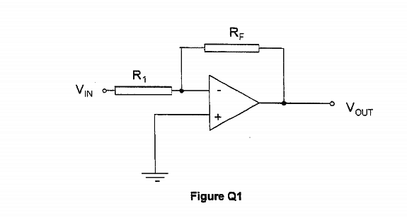

Hi All,
My first post in the forums, hopefully I'll be able to give out as much help as I receive. I'm currently stuck on an Op Amp gain derivation.
Attached is the question and diagram, the derivation I am struggling with is part B.
I understand the gain for this Op Amp were it ideal would be 1+ Rf/R1 but I cannot seem to derive the equation if the input resistance is not ideal.
Thanks in advance,
George

You won't be able to derive the equation in (b) until you have completed part (a), drawing the equivalent circuit with ideal components.
Thanks for your reply Nascent,
I have already completed part A but I can't see how is it that relevant to part B? I know the equivalent circuit and that Rin is in the Op Amp internally and that A is the Op Amp gain.
Any further guidance on how the two relate / where to start with part B would be much appreciated.
Can you attach your completed circuit diagram for (a), with RI and RF arranged around it as in Fig Q1.
Sorry but I don't have any way of uploading my paper working to a computer. It is as in Fig 1, with Rin linked between the + and - terminals of the Op Amp.
That is the circuit you analyze, but this time without a reliance on the dodge of a "virtual earth".
It's the circuit analysis for the derivation here that I am struggling with. Sorry if my initial explanation was poor.
You draw a large circuit diagram. Mark vin. Label the voltage at the input to the amplifier proper, at the junction of the 3 resistances, I called it va.
How will you label the output of the amplifier?

Question to you: The input voltage is connected (via a resistor) to the inverting terminal of the opamp. Wouldn`t you expect a negative gain in this case?
(Your ideal gain value (1+Rf/R1) is not correct!)
You have stated: "I understand that the gain ...".
Did you really "understand"? I don`t hope that you understood a false result! That would be fatal!.
a) This you must draw on your own. If you could somehow take a picture and upload it, we could verify if it is correct. What do you think the ideal values for ##A##, ##R_{in}##, and ##R_{out}## are? Hint: Think about preserving the signal. Do you need a large input impedance or a small one?
b) For the closed loop gain, what equation is relevant to op-amp operation? Use this equation, and the virtual ground between ##R_1## and ##R_F##.
